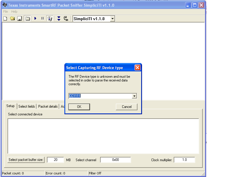

 I am using the SmartRF Packet Sniffer in conjunction with the CC1111 USB Dongle to monitor communication between CC1111 and CC430 everything was ok, I saved the PSD file of the complete communication and I was able to open it again and look at all the packets that were sent during that communication, but today, I tried opening the file and the packets show FCS = ERR and 2 Bytes of the payload are missing on all packets. How could that have happened? Isn't the PSD a static file which is just read by the Sniffer and print on screen? how can it change from 1 day to another?, I also tried opening other files which I had with packets, they all have the same problem, bytes missing from the payload and the ERR on the checksum.
 What could I be doing wrong? As I said I've opened all this files before and haven't had any problems, I didn't change the Packet Sniffer version, I loaded the same Radio Settings used to capture the packets (in case it was needed). Any shed of light you can bring?

    The problem should have been solved in the latest version of the packet sniffer (2.12.3).
    The version used is not mentioned, but in earlier versions there was a problem that the packet sniffer didn't know how the packets in the PSD file was captured. The length field depend on the device. Some devices include the 2 status bytes (FCS) in the length field and others don't. It is correct that the PSD file is a static file, but unfortunately it doesn't contain any information about the capturing device (We have been thinking about changing this in the future). When you open the packet sniffer window and try to open a PSD file without first starting the sniffer, the sniffer would use a default value of the capturing device. This might not be the correct one and the display of the packet could be with 2 bytes less than what was originally saved in the PSD file.
    In the latest version of the packet sniffer you will be asked to specify the capturing device when you open a PSD file. See screen shot:
