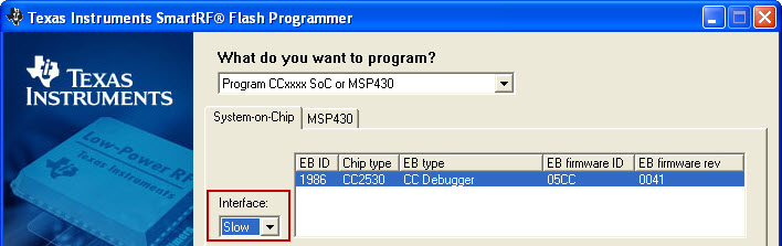

    Have you tried lowering the interface speed?

    Is it possible to change the speed from IAR, we program all our devices from there.

    You can reduce the the interface speed in IAR under Project > Options > General Options > Debugger > Texas Instruments > Target.

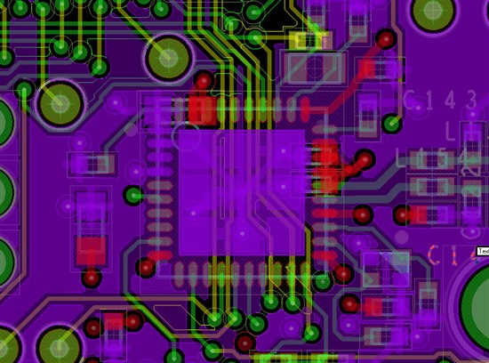

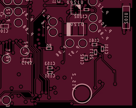

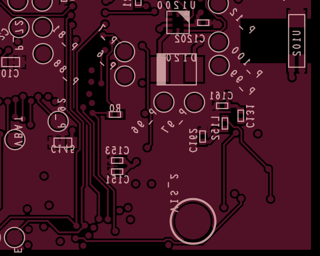

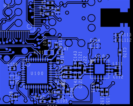

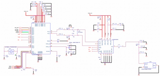

  • Hi Igor,
    Sorry for the delay, here is the schematics and the layout top and bottom of the CC2530 + CC2591 design.
    We still have the problem, we really don't see what happens, and we are considering a new design.
    If you have some ideas, they are really welcome.
    Valentin
  • Hi Valentin,
    Sorry for the late reply, I was abroad.
    From your schematic, I can't see how exactly the debugger connects to CC2530 device.
    Are there any vias between the large pad (CC2530 #41 pad) to a solid ground. I can see
    the ground pad connected to a solid ground through pins 1-4, is that all?
  • Hi Igor,
    Here is a view where you can see the 4 vias connecting the ground pad to the GND internal plane and the bottom ground plane.
    For the programmation pins, they are connected to the other side of the board with a 7cm net for each signal. PGD, PGC and nReset are not perfectly parallel, but their length are about the same.
    Any ideas ?
    Valentin
