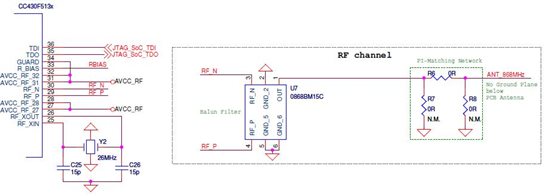

For better understanding the problem here I describe my PCB design.
One of the main constraints for the PCB design was using a Low cost antenna, but with good performances, so I choosed the Monopole PCB antenna (single band 868MHz) presented in Design Note DN024.
I simply followed all hints suggested in the Design Note and, for a future fine tuning, I also added a pi matching network (by now is simply a 0Ohm resistance connecting the Balun to the Antenna).
Because I had some space occupancy constraints, I used the proposed JTI (Johanson Technology) Matched Balun Filter.
So my system is as follows: CC430 RFN/RFP pins - JTI Balun Filter - Pi Matching Network - PCB Monopole Antenna @868MHz.:
Regarding the 26MHz quartz I followed all rules explained in the data-sheet, selecting two 15pF capacitors which, together with the parasytic capacitance on the pin (around 2.5pF) gave a 10pF equivalent capacitance: (1/ ((1/C25)+(1/C26))) + Cparasytic = 10pF.
This capacitance value is ok for both the CC430 and my quartz, whose load capacitance is 10pF.

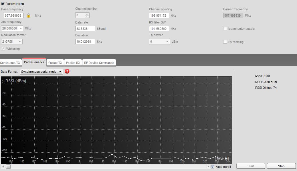

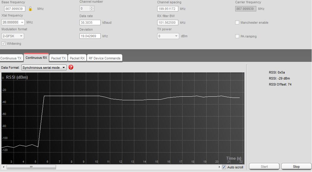

Furthermore I made the following Experiment: I simply downloaded on the EM430 and on my PCBs a Firmware which simply continuously sends  a SYNC word @868MHz, 38.38kbps (sending a Strobe(RF_STX) command).
Using the SMART RF STUDIO 7, configured in Continuous Rx mode I have the following result:
  1. Using both EM430 as sender and receiver: RSSI goes up as soon as I switch on the EM430 continuously transmitting SYNC word @ 868MHz
  2. Using my PCBs as sender and receiver: when I switch on my PCB for continuously transmitting SYNC word nothing changes in the RSSI which, strangely, is below the sensitivity level! How can this be possible?

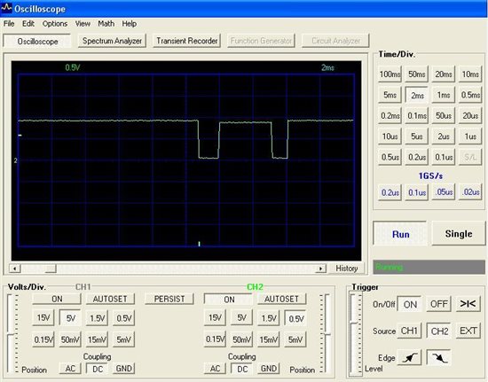

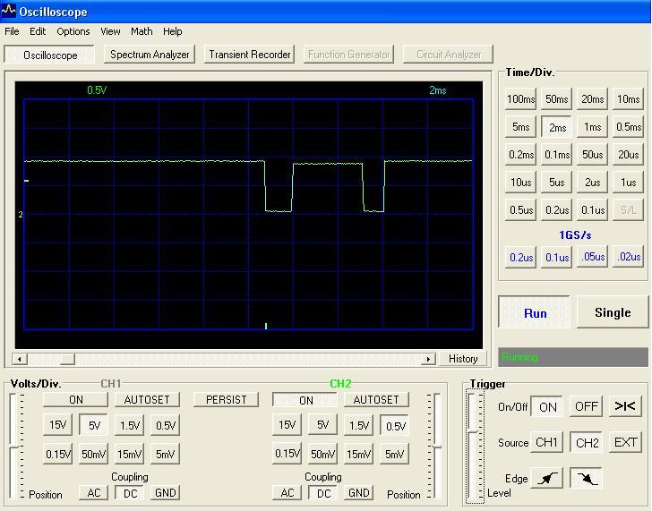

In addition to this, I did another test to better understand if my sensors are, at least, transmitting something:
Using my 50 MHz oscilloscope, which I know is not suited for such high frequency signals, but is enough at least to see the signal shape, I checked the voltage values on the RF_N and RF_P pins on both the EM430 and on my sensors when they transmit a 13Byte packet @868MHz, 38.38kbps.
Using both the EM430 and my sensors I have the same signal on the RF_N pin:
The signal goes down at each transmission, then stands up for the transmission time, then goes down and then up again. The ON time is exactly equal to the time spent for sending the 13 bytes (including Preamble and SYNC).
This seems to me to be good, because at least the output amplifier sends something.
The only difference between EM430 and my sensors is that the RF_P signal has exactly the same shape, but a slightly higher voltage value during the ON phase if compared to the RF_N signal. This does not happen on the EM430 where the signal is exactly the same.

    One more thing is that, checking on the Continuous Rx scope of TI SmartRF7, using as receiver the EM430 and as transmitter the other EM430 board, the RSSI value is high, as said in my first post.
    When I use my sensor as transmitter and EM430 as receiver the only thing I notice is that the noise floor stands at about -110dBm, as expected, and when I activate the sensor for continuous transmission the RSSI value rises to -88/-90dBm.
    This behaviour, unexpectedly, is viewable along a wide range of frequencies: 868MHz +/- 20MHz!
    So, to me, it looks like that my CC430 is sending something, but it look like it is spread all over the bandwidth!

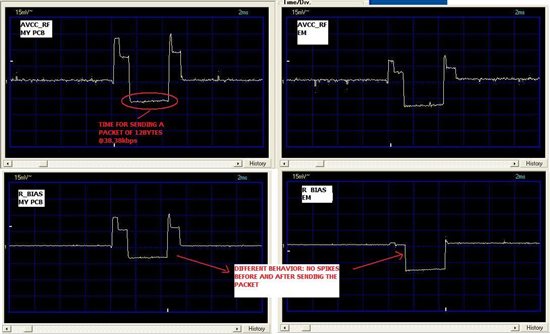

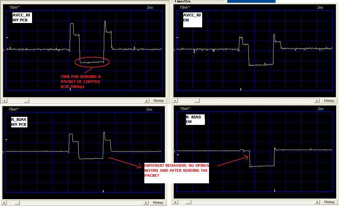

    Considering that this test didn't success I wanted to make a new on to give another look to the main voltages. I kindly and ask you, please, to give a look to the following results!
    I checked the AVCC_RF/RF_N/RF_P/R_BIAS signals with this test:Using the "Fixed_LT_FIFO" firmware donwloaded from TI website,which sends a packet once you push the button key, I monitored the previous signals at each packet transmission and got a slightly different result on the EM and on my PCB:
                 All signals are without the DC component (Oscilloscope set at 15mV/division; Supply voltage is 3.1V).
    AVCC_RF and R_BIAS behavior at packet transmission (button pressed):
    I notice that the AVCC_RF behaves almost the same way on my PCB and on EM.
    A slightly different behavior is noticeable on R_BIAS.
    Is it possible that this different behavior causes the system not to work correctly?

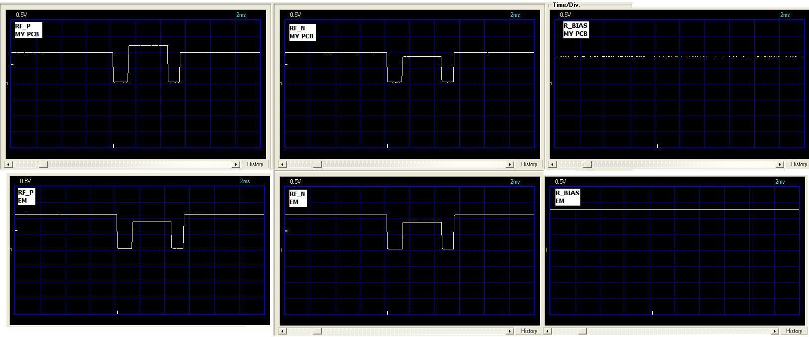

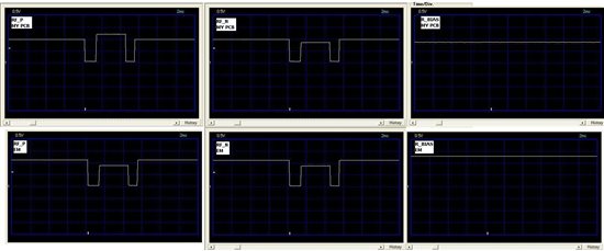

    • RF_N/RF_P/R_BIAS behavior at packet transmission (signals are with DC component):
    A different behavior is noticeable on the RFP/RF_N signals. On the EM they are perfectly identical. On my PCB there is a different DC value during packet transmission.

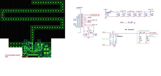

    You say that your board and our EM are identical, is that valid for the layout as well? Could you post your layout so that we can check this as well? How many of your own boards are failing? Have you looked at the soldering and everyting looks ok? Have you tried your XTAL on our EM? Have you tried swapping more compoents between the boards for intstant the chip? How is your power solution, have you tried external power to the CC430 chip?
  • Hello!
    Hereunder I attach a picture of the antenna output layout, using the JTI Balun Filter (0868BM15C0001E).
    Of course the layout is just a bit different from the EM because ,for space constraints, I needed to use the Balun Filter by JTI. Anyway I've followed all layout suggestions I found on TI Deisgn Notes as DN025, DN024.
    The picture represents only the antenna output side of the CC430.
    As Voltage supply I use a Lithium Battery, so Output Voltage is 3.6V. Voltage supply goes directly to the devices without any DC/DC reg.
    In the previous tests I used as voltage supply the MSP430 debugger (msp-FET430uif), and Power Supply was 3.1V. In both cases (3.6V or 3.1V the board does not work). I did not try with other external supplies.
    I tested the behavior on 10 PCB I produced, so this is not a problem of just one PCB. To me it seems not a soldering problem. Probably if it was a soldering problem it would appear on just one board, not on all of them. What do you think about this?

    After all measurements suggested by you and your useful hints and help I simply considered that it was not a problem of settings, Clock, coupling capacitances or soldering.
    in fact it was a production problem! Our suppliers mistakenly mounted a 2.7k resistance in place of the necessary 56k resistance as R BIAS! Considering that it was a 0402 resistance it was not possible to see it by eyes! And, furthermore, the component was sent to our production site in the correct ESD shielding envelope, indicating the correct product code.
    Of course all antenna output stage did not work properly!
    All my indirect measurements on RBIAS gave the same result as the EM, that's why I could not imagine that such a rough mistake could have been done by a worldwide Electronic devices supplier.
