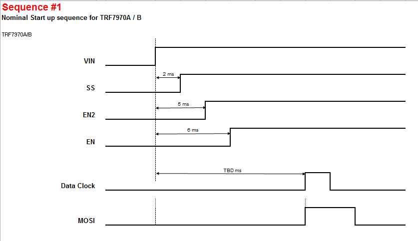

Hi all~ this Sungho from LG electronics
I have some questions about EN pin and TX_OUT.
After EN pin(TRF_ENABLE) is ON...How long should I have to wait for stable operations of TRF7970A.
When I put some short time ( < 1ms ) I can get square wave(6.77MHz) from TX_OUT after CHIP_STATE_CONTROL(0x21) command.
But if I put long time( about 3ms or more)....I can`t get square wave from TX_OUT...
As I know...there should be 2 or 3 ms delay between EN high and SOFT_INIT...
I really want to know the exact timing.
And one more question...when I set NFC_TARGET_PROTOCOL register with 0x24 (ISO14443 A)..there disappear TX_OUT square wave...is this right?
Somebody help me please~
