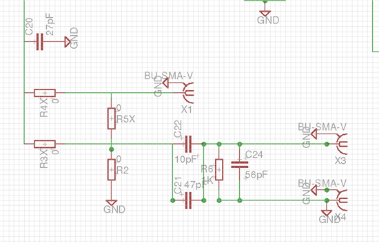

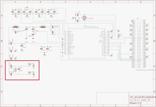

Hallo,
I'm trying develop a PCB layout with the TRF7970a connected to an other MCU via SPI. I stick total to the specifications and the layout from TI. I want to replace the loop antenna with two SMA connector and I want to leave off the RF Test Port.
1) For what are the 0 Ohm resistors?
2) If I leave the RF Test Port off, can I leave also all components with the value DNP off too?
3) To establish a connection via SPI, do I need the connect the DATA_CLOCK (Pin 26) or the SYS_CLOCK (Pin 27) to the my processing MCU?
Thanks and best regards
Flo
  • Flo -
    you need to connect one side of the coil to ground.(so the way you have it drawn, the bottom SMA would not do anything for you)
    i would recommend you still keep the pads for a connector (you could use U.FL or SMA) for some way to make sure your design in working - that is the intent of the EVM connections you are now wanting to remove - it allows one to look individually at just the output of the impedance matching section, the tuning of the antenna or connect up another antenna coil for experimentation, using a known good system.
    also see ==> http://www.ti.com/tool/trf7970atb
    regarding your clock question...the EVM and -TB schematics and the data sheet give this answer as well - as name implies, the data clock would be coming from the MCU  to the TRF79xxx for the data communication interface, the system clock is output from the TRF79xxx device and can optionally be used for the MCU in your system - but many MCUs (like many MSP430s, for example) have DCOs so using that output would 100% be your choice.
  • Dear Josh,
    thanks for your reply.
    I have added a GND to the lower SMA connector and I have added a SMA connector as a test port. But I am not quite sure about the pins of the test port. At the TRF7970A EVM PCB it looks like a SMA port, but in the schematics it does not. I am confused.
    And now I have understood the difference between the SYS_CLOCK and the DATA_CLOCk. I think, there were some language difficulties up to now :)
    Flo
  • Flo - where you are showing X3 and X4, these should just be your coil connection.(i would not put sma or any coax connection there, plus X4 just shorts center conductor to GND)
    the symbols are what the tool uses to indicate a coaxial connection...there are many variations in use, so use this information as new knowledge.

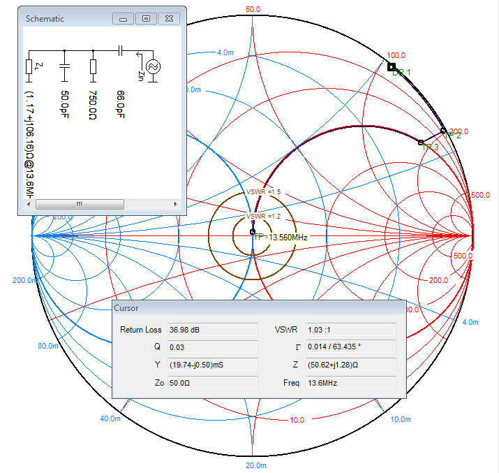

    regarding your antenna - it seems you have ~1.2466uH antenna. (based on your complex impedance value)
    you can check out section in TRF79x0ATB user manuals on the topic too, but here below is the short version, based on your values.
    so then if you want to hit a Q value of about 8 or so, you can multiply the XL by the Q value you want to hit, to get the first value to use of the shunt resistor used for Q dampening. This yields 849.25 Ohms...not a standard value, so go down to 750 Ohms and then plot the tuning solution. This should get you in the ballpark to fine tune from here.

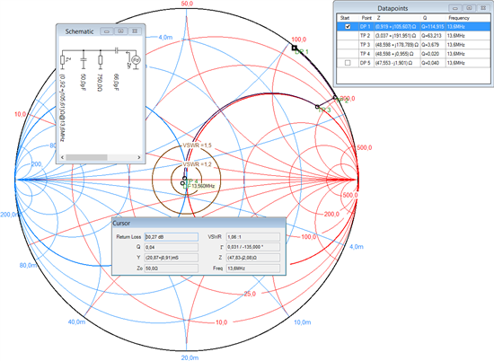

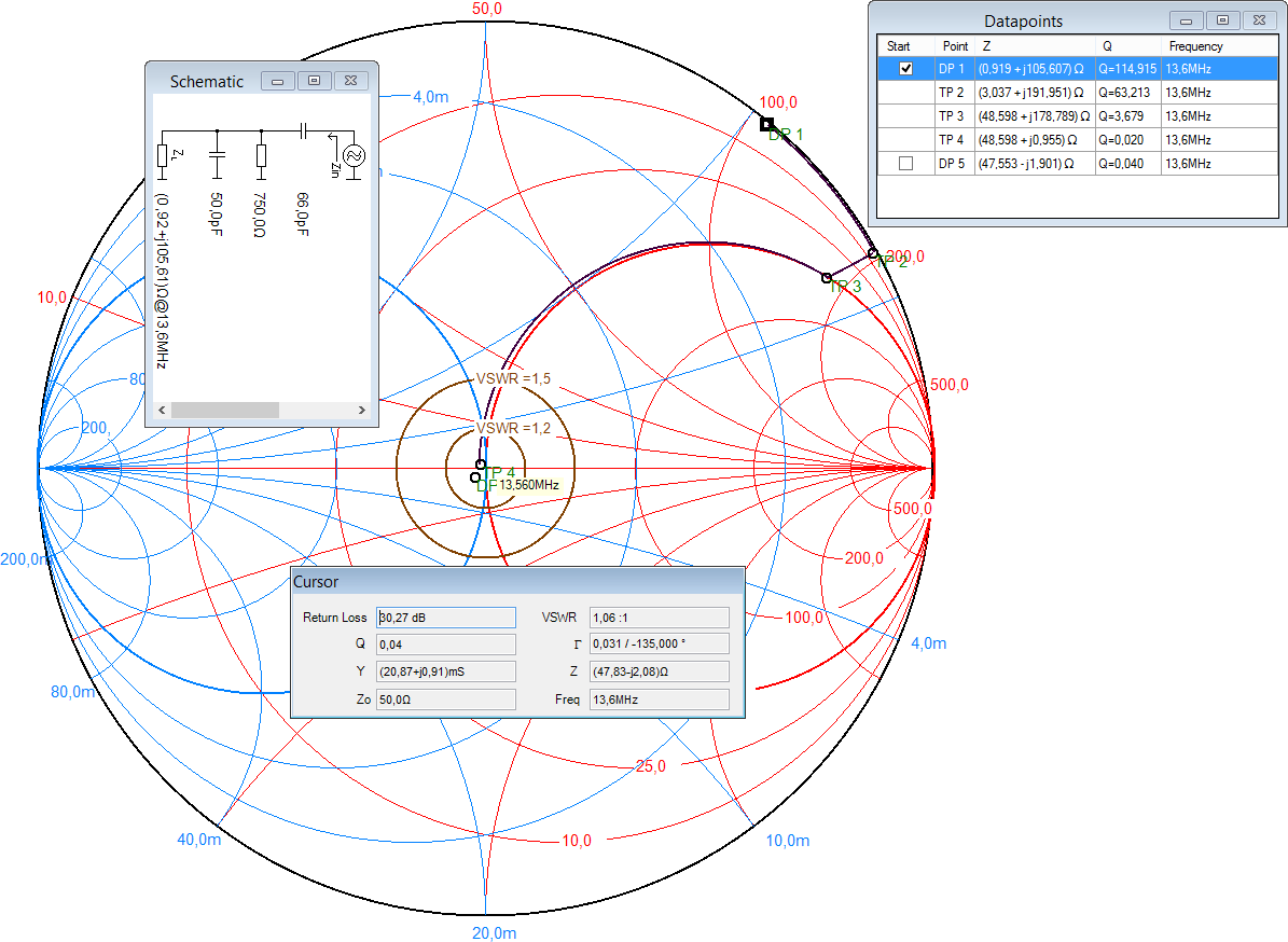

  • I did new measurements and here is the simulation on Smith Chart software and the point that I got after put this tuning solution on board.
    Have you an answer to the SYS_CLK issue? The pin still have a clock between 60Hz-70Hz.

  • Fernando -
    as long as the EN2 pin is high, the SYS_CLK will be putting out the default osc. frequency, even if B4 & B5 in register 0x09 are 0. We will update the DS to reflect this.
