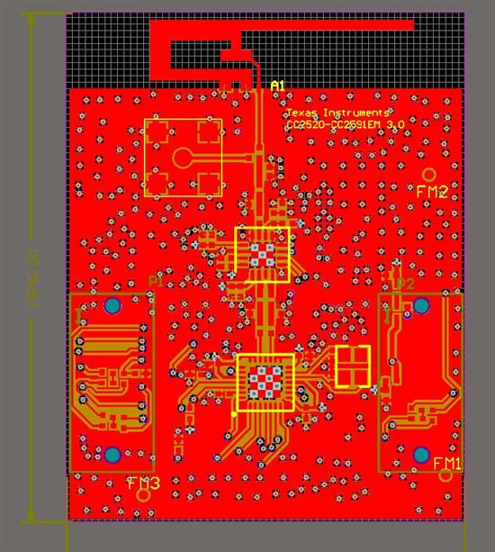

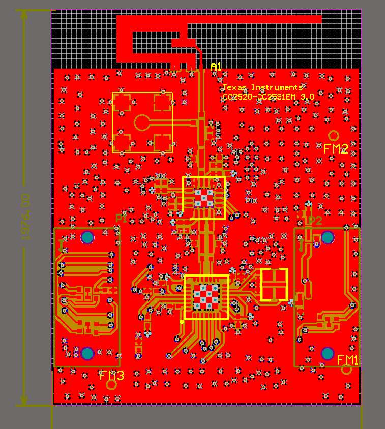

  • The antenna is on the top layer.  I opened the converter file and saw the same thing.  It looks like the polygon pours are lost in the translation.
    The following is the file in Altium (Summer 2009) where it looks like all of the layers are intact including split polygons.  Can you use Altium files or a full set of Gerbers? By DXP do you mean Altium?

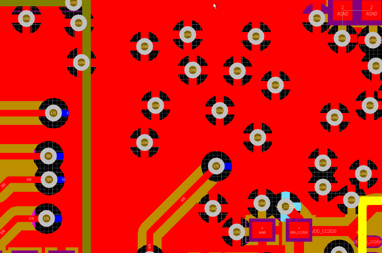

  • Ok, here is how it is looking right now. I am able to select the components from the top and bottom both, which are visible. I have turned on all the layers. The green is the mile layer. I had a question also. When I select a component, such as for example, from either of the chips, then I ass a matrix of pads in the inside portion of the chip. Since these are the QFN parts, this is I believe supposed to be like that. But I do't understand that these are running from top layer to the bottom layer, the pads or vias in the inside area of the QFN components I mean, or are they running from top or bottom layer to another layer?

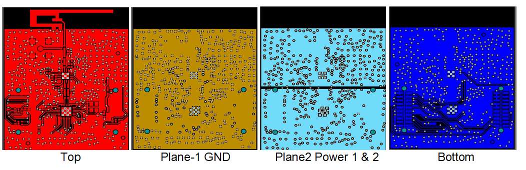

  • Here are the 4 planes. Other than ground vias there are no QFN pads on layers 2-4

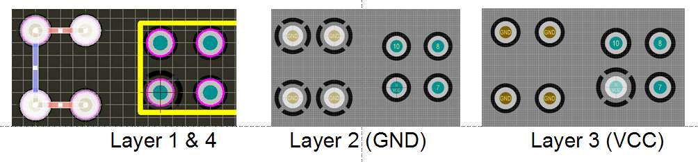

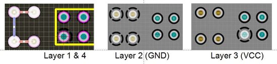

  • A common 4 layer board is like this:
    1 ---Top signal Layer with copper pour connnect to ground-----
    2 ------------------------ Ground plane ---------------------------------
    3 ----------------------- +3Vdd Plane -----------------------------------
    4 ------------------------ Ground Plane ---------------------------------
    All vias go through all layers top to bottom. (Yes, it possible to have "blind" vias that go between layer pairs but it costs a lot more.) The nice thing about 4 layers with a power and ground plane is if you need power or ground you just pop in a via and you are connected. You do not have to route traces for power or ground. They are always there by adding a via.  The BIG advantage is the ground plane is continuous, without breaks, because it does not have lines. A continuous ground plane is important at 2.4GHz. If you look at a simple Ti design like a CC2430EM you will see the ground plane on the bottom layer under the RF matching section does not have a single break or line. With more complex designs this becomes nearly impossible with 2 layers.

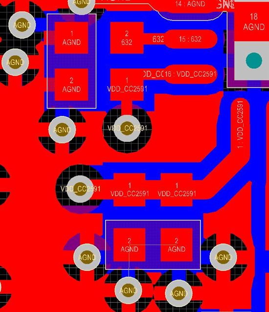

    If you look at the photo where I zoomed in on the Vdd lines for the CC2591 notice how the Vdd comes from the via, goes to the bypass cap which is grounded with a via, and then to the CC2591. The lines are short, the ground pour on the top, layer 2 and the bottom are not broken by a Vdd trace, and the person doing the layout didn’t have to figure how to route the power all over the board. There is little worry of coupling between devices due to a long Vdd line connecting them which could cause feedback and oscillations. When you route a Vdd line and add a via it automatically connects to the Vdd plane.
    The power and ground plane do not have signal traces on them. All signals are on the top and bottom.

    To answer some of your questions:

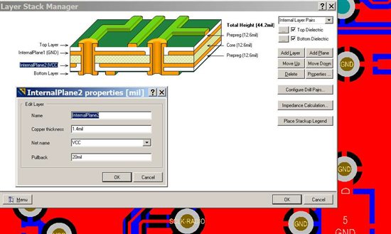

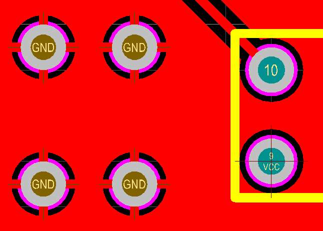

    The layer order is Top(Layer 1), Ground(2), Power(3), and Bottom(4).  The reason is the RF transmission lines are of a certain impedance. Impedance is controlled by the dielectric properties of the PCB material, the width of the line, AND the thickness of the PCB material between the line and the plane below it. If the power plane is directly under the RF lines on layer 1 then the power plane becomes the RF ground plane which, while possible, is difficult because the Ti chips use the same “ground” for dc and RF.
    All of the vias go from top to bottom. If the via is on net VCC and the power plane is also net VCC the via will automatically attach to the VCC plane2 (3). It will automatically have a clearance gap where it goes through the ground plane(2) and also on the bottom(4) so it does not connect to the copper pour on the bottom which is connected to net ground.
    Look carefully at the picture from the Altium Layer Stack Manager to see this better. My power plane labeled VCC is only connected to +3.3Vdc output of the voltage regulator. You can use a layer instead of a plane where it is possible to use polygons to define different areas connected to different nets (ex.: Net Vdd3.3V, Net Vdd5V,)

    Adding Planes  under the design tab I have "Layer Stack Manager".  I'm sure you have something like this.
    On a blank part of the lay out area right click, select Option, then select Edit Nets... Here under Net Class add GND, set the annular ring size, hole size, and line width. (ex 40mils, 20mils, 10mils)  Once the nets are established you can go to the next step (If you have a schematic all of the nets would already be here). I'm trying to find a way to add all of the nets to a table to save some work.
     In stack manager I click the top layer, then click Add Plane. Once it is added I double click it add set the Net name to GND.
     Still In stack manager I click the bottom layer, then click Add Plane. Once it is added I double click it add and set the Net name to VCC or what ever you are using. If you want more than one plane on this layer click Add Layer. Later you can select this layer a draw a polygon for each plane and attach each one to a different Net (eg VCC33 and VCC5)

  • Here is what I see. Cctrl H works nice, I didn't know about it before your posting. On layer 2 you can see the 4 vias connected to Layer 2 (Net GND), on layer 3 there is the clearance and no connection for the GND vias but you can see pin 9 of the 10 pin header is connected to VCC and had clearance on Layer 2 (GND). I just put the ten pin connector down, right click on pin 9 and selected VCC for the net.  The software did the rest.
    If a pin that is passing through the board is not on net VCC or GND it will not connect. There is nothing you have to do. Even when you add copper pour to the top and bottom and attach them to GND only thru hole pins on Net GND will be attached to tese pour as shown below. Note the relief around VCC and pin 10. It is automatic.

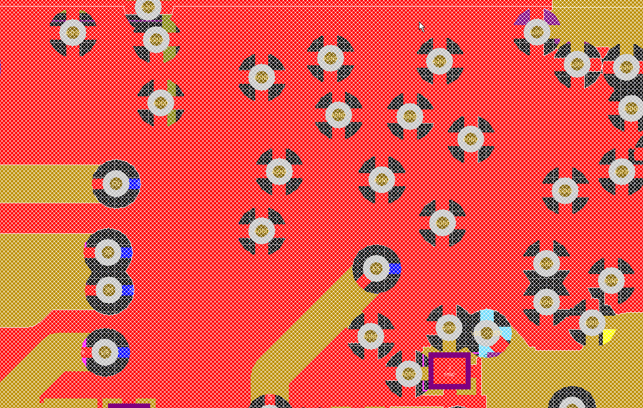

  • I would like to go back to our previous discussion, in which I mentioned my problem about not being able to use the Net in the four layer board in order to get the proper board overview. For example, I said, I have a dual layer board, and I attach all the VCC together, then I can see all the VCC connected lined high-light together, even if it is running on both sides of the board. But this is no longer the case, if I introduce two more layer, one ground and one VCC, and then try to route the power lines over those, which means, if I now try pressing ctrl+H, I do't get the proper high-lighted tracks which I should see. I also said I do't know the reason for that, and I have tried defining nets, and including the layers in the Nets, and assigning the vias and the tracks to nets, but even after that, when I click a track which is running through the via to the power plane, to another track or component (on now my two layer board converted to four layer board) and then try ctrl-H on them, I do't see them highlighted, even when they are on the same net.
    What I do't understand is, that if I open the file which was for the Altium (the CC2591 file saved from CADSTAR format to Altium), adn then for example click any via which is running to the ground layer, then I see the whole ground plane high-light, including all the ground vias, and the tracks running to the ground.
    This I have tried capturing via the screen capture tool and attached it. Sorry I am having little bit of problem about attaching the files, I am going to attach them with the next post.

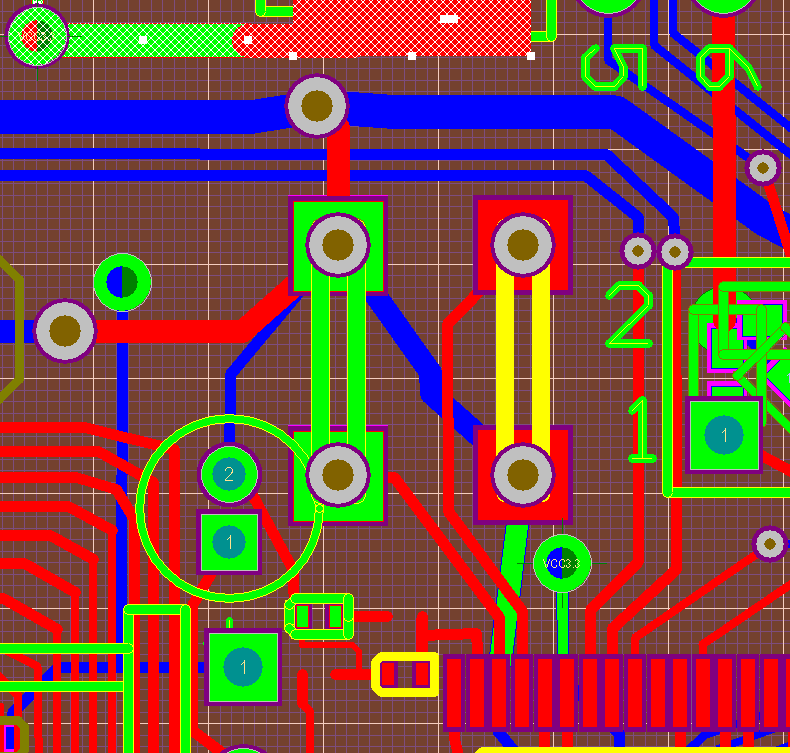

  • The part which I am talking about here, is the one that the file was originally a two layer board, which I had all the signal and power running on the two layers. Thus when I wanted to see an overview of the VCC or GND, I would just run ctrl+H and see them all high-lighted. The file which I have attached here, is the one that I have inserted two more layers. Now there is a GND and VCC plane, below the TOP and BOTTOM layers. If you look closely, on the top I have placed a via running from the TOP layer which is the red color, to the VCC3.3 which is greenish color, and there is also a Net the VCC3.3 net. I hve also run ctrl-H, which is supposed to show the interconnections, thus the all the interconnections on the TOP going to this via are high-lighted. Next, I have a via at the lower part of the screen. This is running from the BOTTOM layer to the VCC3.3, which is also represented by the colors, BLUE to greenish color, the greenish being the VCC3.3 layer, there is also the VCC3.3 Net, which can be seen on the via.
    Now as far as I am concerned, the via on the top of the screen which is running from the TOP layer to the VCC3.3 plane, and the via on the bottom of the screen, are interconnected, one from the top layer to the VCC layer, and the other from the bottom layer to the VCC. But as you can see, when I have tried to check interconnetion between them by running ctrl-H, there is nothing to show me an overview or high-light. Are these not connected then? What may be the problem and how may I solve this design problem I am having.
  • First the bright green items are those with design rule errors, you can turn this off by using Tools / Reset Error Markers
    Most PCB design tools are designed to work off the Schematic which provide the interconnects on a net list making functions like ctrl H easy to implement in software by highlighting all object on a given net.
    Without a schematic you need to right click every pad, plane, fill and line and individually assign them to the desired Net. I notice that many of the vias in the photo do not have a net label in their center.
    I have created a PCB only file to see what you are seeing.  When I assign lines and vias to a Net, like AGND, and click any on the same Net, on top or bottom, they all light up using ctrl H.
    If I do not assign 2 lines or pads to the same net the software will not let me connect them. One way around this is to change the design rules to permit shorts, which I would not recommend doing. If I add 2 lines while permitting shorts and then add a 3rd line connecting them ctrl H does not work.  Even through they look “connected” they are not the same net. Ctrl H highlights items of the same Net. It does not highlight all items that just happen to be shorted together.

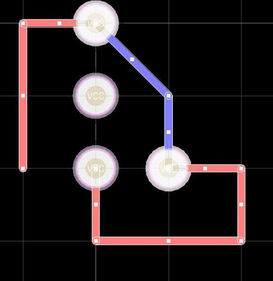

  • I started a new PCB in Altium, by clicking New->file. Next I clicked the layer stack manager and added two more layers planes, as shown in the files I have include. Just before that I also defined the Net called VCC, so that in the layer stack manager I can add the plane called VCC to the Net VCC. Then in the new pcb, I added two vias, on running from the bottom to the vcc plane, and another running from the ground plane to the vc plane. I added the vias to the VCC net.
    I do't get it that why when I click on the first via using ctrl-H, I cannot see both the vias highlight? This time I have started from a fresh pcb, I have clearly defined the layers, and created Nets all from the beginning. Just I have no schematic. I have whatever which is on the pcb in the nets, nothin which is not placed on the net. Clearly, the first via is attached to the VCC plane from bottom layer, and the second one is attached to the VCC plane from the top layer, why can I not see them connectes, when both the vias and the VCC plane is in the net VCC?
    I did the same thing by starting with a new project.  I defined a Net call VCC, I added a Plane for Net VCC and then added 3 vias adding only 1 of them to Net VCC.  I routed the 3 vias at which point they all became named VCC.  I added via 4 and used properties to define its Net as VCC.
    After selecting ctrl H and clicking the end of the free line everthing, including the unatached via was high lighted. I might think it was a software version differece but you saw it work with a previous file.  Maybe it only works in the older vesion if there is a Net list from schematic?
