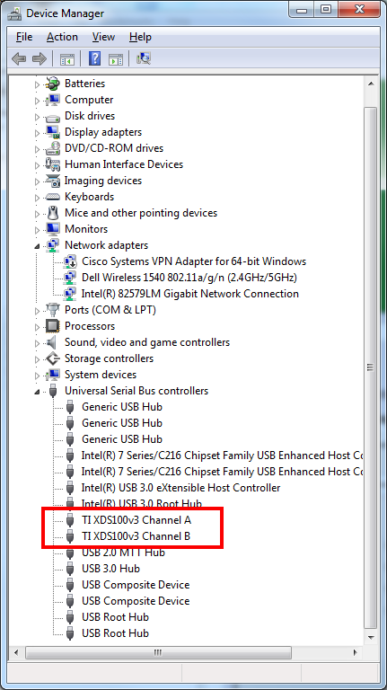

    The SmartRF06EB board will not show up as "Cebal controlled device" because it uses a different interface. I was not able to find where it is described as "Cebal device", but if you could tell me which user guide this is mentioned, I could take action to get this updated. The interface is based on an XDS100 emulator and the device will be visible in the device manager as shown in the screen shot below:
    In SmartRF Studio you have to click on the "Refresh" button to get this device in the list of connected devices. The list will not be updated automatically when you connect the device. When the list has been updated it will look like shown below:
    The target device will be listed as "unknown". When you double click on the list item you will get a popup dialog asking for the type of target device. If you don't see anything in the list of connected devices after a refresh of the list I suspect that something is wrong with the driver installation. Verify that the Device Manager looks like the screenshot above.

    Moving on, the device manager does look like the picture you described under the USB header.

    To make sure you get the correct drivers installed it would be worth a try to uninstall the drivers for "XDS100" devices. Select "Show hidden devices" under "View" in the device manager to ensure that you see them all. Then uninstall and install SmartRF Studio again.
