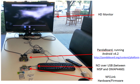

  • yes - but - to be clear - you will need to use MSP430F5529 + TRF7970A...this is the standard NFCLink hardware/firmware set, then the Android stack side is handled via what we can provide you that was developed with our partner Stollmann. Let me know if the below is something you can deal with - (you need MCU here, running NCI to/from Android)
    Currently, we are running this on a Pandaboard + the HW mentioned above (see picture) - then:
    • Image and drivers are loaded onto SD card (for Pandaboard).
    • When Android system is powered up, with the NFCLink hardware connected; then NFCLink hardware will activate switching between being reader/writer, initiator and target.
    • Card emulation is not supported here in this particular demo.  (as this version of Android (pre-Kit Kat) does not support CE, this can be modified as the HW and lower layer firmware is supporting this)
    • User is able to write NFC apps using Android SDK as normal for NFC devices and use this hardware configuration as a drop in.
    • User is also able to use current Android apps already in existence (just like what you can do today with any NFC enabled handset)
    • This uses MSP-EXP430F5529 + TRF7970ATB hardware combination and uses NCI over USB.
    • User would operate this hardware configuration like any tablet or handset (but with keyboard and mouse and shown here with HD monitor)
