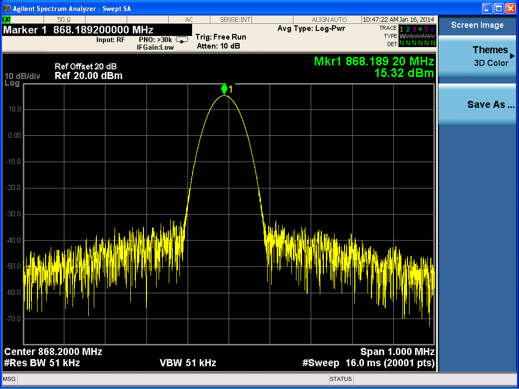

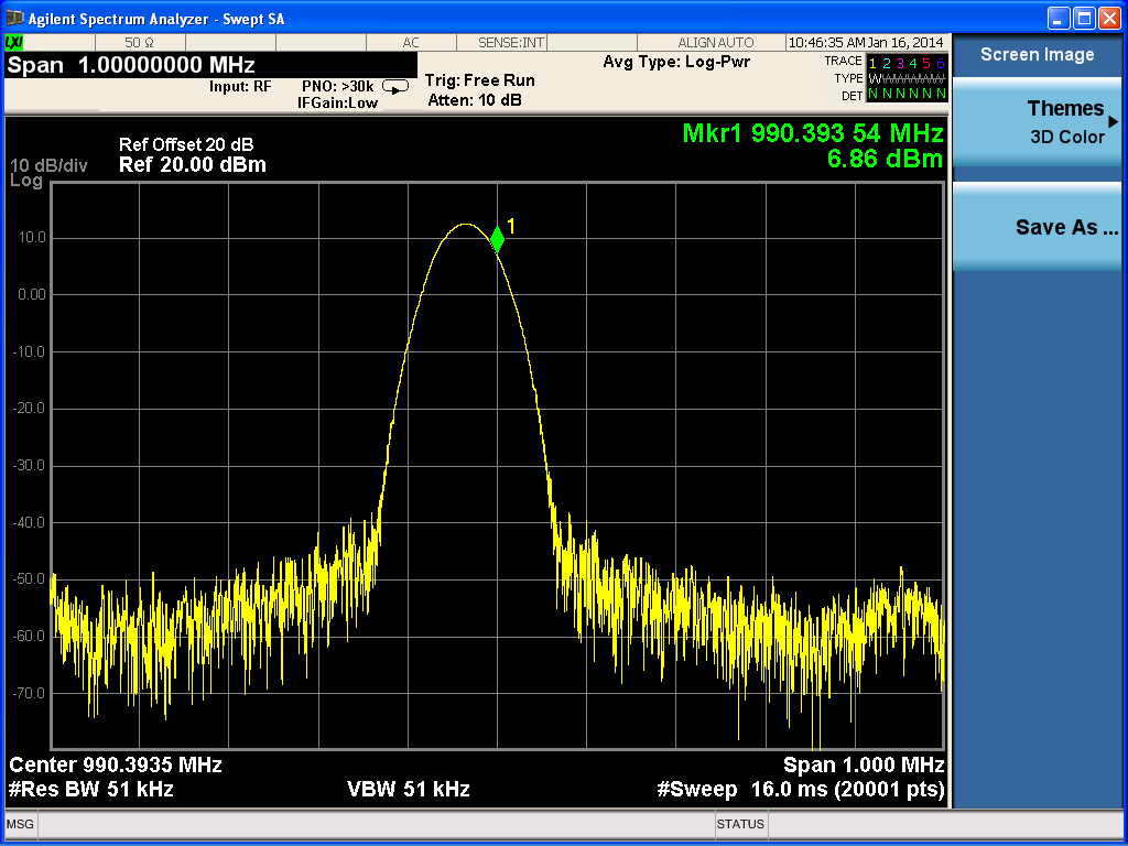

These 3 steps are in a loop, and in the 90% of cases I saw the carrier at the expected frequency (868.200 MHz).
In the 10% of cases, the carrier is shifted forward of 100/150 MHz.

  • - Which frequency do you send on when sending on the wrong frequency.
    - Could you post the complete code? From reading your description it sounds like you do it correctly but if that was the case you would not end up sending on the wrong frequency.
    The Freq is about 990 MHz
