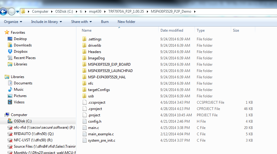

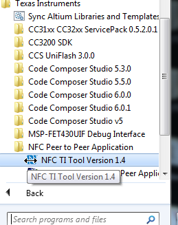

  • Please send a link to the latest NFC P2P firmware...In the link
    http://www.ti.com/lit/zip/sloa192 only GUI installer is available..
  • if you run the installer - then it will load the P2P GUI and the project onto your PC.
    and the code project
