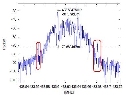

I have a problem with configuration of CC1200 to cooperate with the CC430 and CC1110EM.
Communication in the direction from CC430 to CC1200 works properly, the problem is the reception of the data frame by CC430 when I send it with using CC1200.

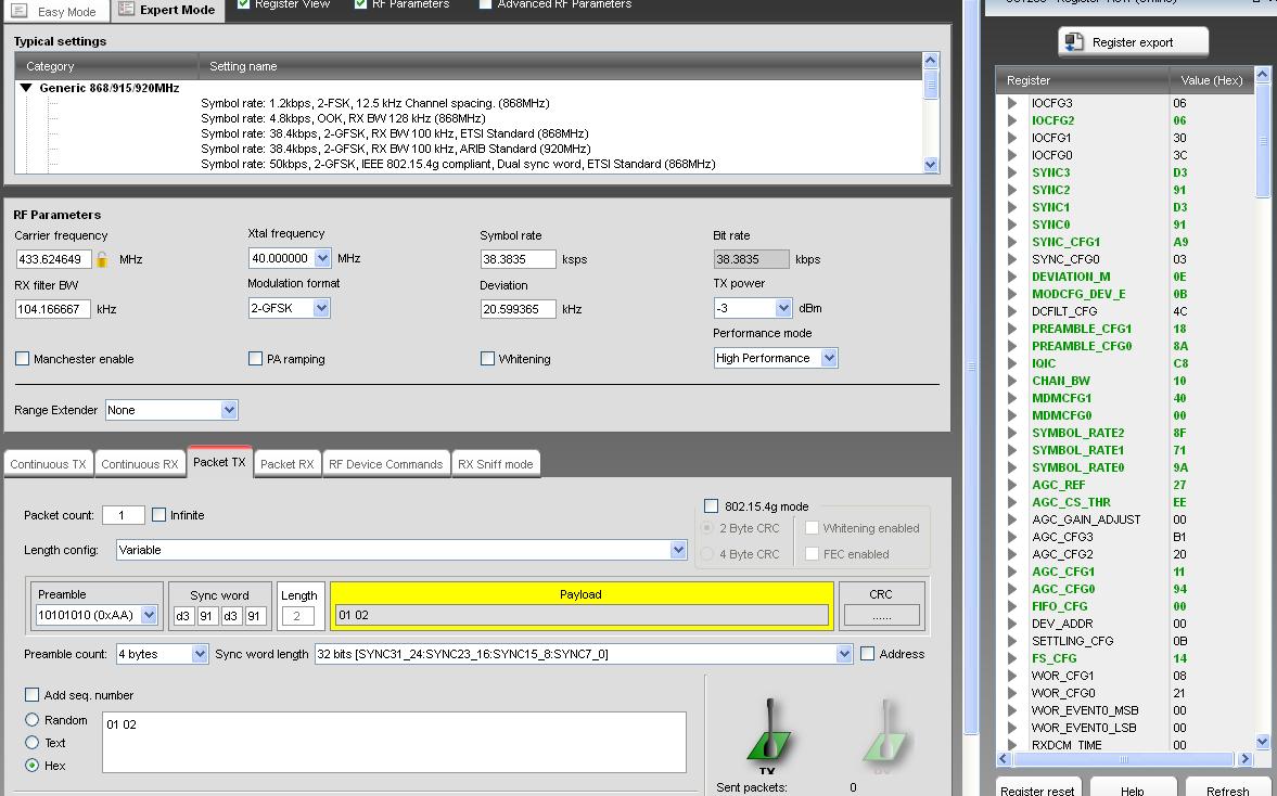

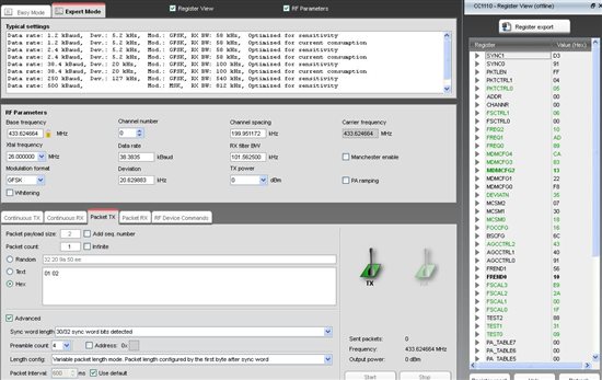

To eliminate potentially hardware problems I used the factory modules CC120xEM and CC1110EM rev 2.0 connected by CCDebbuger to SmartRFStudio.
After registers configuration I try to establish communication with PacketTx and PacketRx options available in SmartRFStudio. The effect was the same as before, ie if the packet was sent by CC1110EM, CC120XEM recived it correctly, but when packet was transmitted by CC120xEM, the dialog box PacketRx of CC1110EM module was empty.
Transmission parameters and data frame (set with using SmartRFStudio) put below :

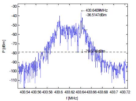

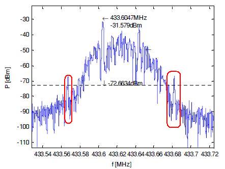

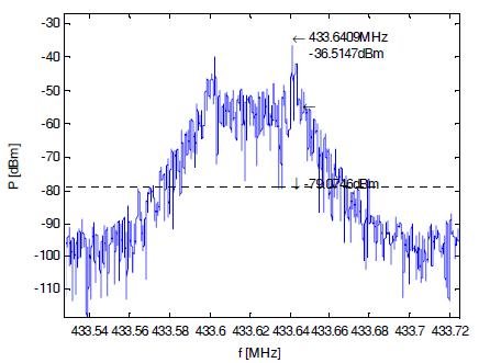

During the experiments I checked the carrier frequencies, deviation and modulation (with using spectrum analyser) and both modules agree with the accuracy up to ~3kHz , also physically transferred data frame in both cases are consistent (both transmited data and baud rate). Of course, I will enclose the appropriate measurements if necessary.
What might be causing of this problem - any suggestions?

    I have attached the xml files for my testing.
  • When I opened yours xml files recive buffer window in packetRx mode of SmartRFStudio is still empty. If it's no problem please include screen shots with active packetTx window for CC1200 and with active pacetRx for CC1110 window.
    Is there any difference between the 2-GFSK modulation and GFSK?
    Please look at the results of measurements of the spectral shape of the spectrum for CC1110 seems less "gaussoidal" than CC1200 spectrum.
    Moreover, what may be the source of the peaks in the spectrum marked in red? Are they normal?
    CC1110
    CC1200
    Thank you.
  • I noticed that when opening the xml files I sent you that the payload had disappeared from the Tx side. Please find the screen shots attached. 1261.E2E_test.docx
    Both radios have the same modulation format. The two extra "spurs" can also be seen if you generate an ideal GFSK in Matlab.
  • I know about the additional peaks at GFSK spectrum but it confused me a little that in the CC1110 spectrum they are poorly visible.
