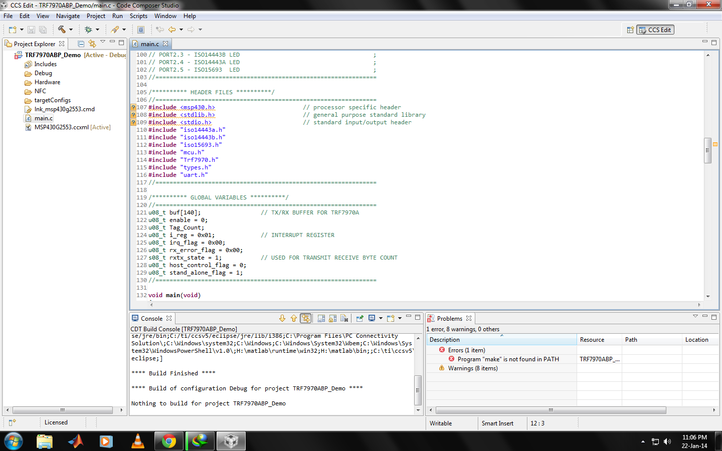

hello,
 iam using a trf7970a nfc booster pack on the msp430g2553 .when i execute the demo project i get an  error saying "Program make is not found in PATH"..iam new to nfc ..please provide an answer to this error...thanks in advance..iam including the snapshot of the error
  • Hey - just delete that project in CCS (i think its corrupted possibly from you adding just the files i sent over) - you can always re-import
    then load this one -  it has more features than the original - see if it works for you.
    http://e2e.ti.com/cfs-file.ashx/__key/communityserver-discussions-components-files/667/1778.TRF7970ABP_5F00_G2553_5F00_with_5F00_Tag_5F00_Data_5F00_Reading_5F00_v2.7z
  • no..iam still getting the same error and also iam getting question marks on #include<msp430.h>,#include<stdio.h>
    and #include<stdlib.h>..iam attaching the snap shot..i went through some previous questions on the same error they suggested to check the "use default build command" option in project>>properties>>c/c++ build..should i do that ?

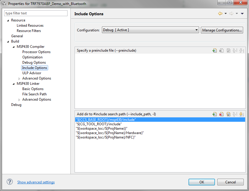

  • Hey,
    I believe the issue is you are missing the basic MSP430 files and possibly the MSP430 compiler.  You probably need to install MSP430ware: http://www.ti.com/tool/msp430ware.
    Below you can see the Include paths.  These 3 files should be in msp430/include and /include.
    The _ROOT's are macro's defined on this tab seen below.
    Check to see if these paths exist.  If you have an older version of CCS, you may need to update this paths to point to your version.
    JD

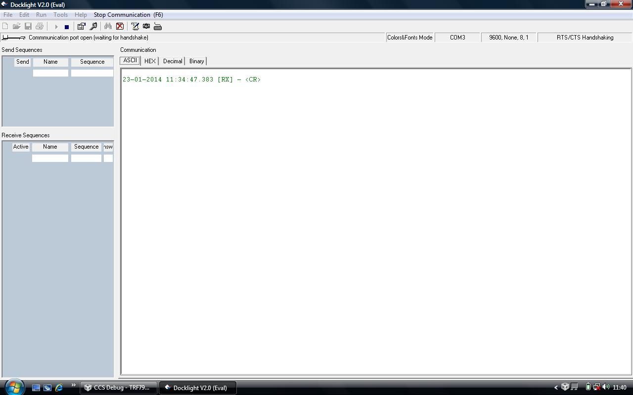

  • i installed ccs v5.4 and the code worked fine in CCS...but  after running the main.c in CCS i went to docklight and did the routine steps but after i start the communication , its  not detecting or reading the tag. i have put the snapshot here
  • is the red LED on the launchpad blinking?
    if not, hit play on the CCS or stop CCS and hit reset button...also check and make sure you have the IRQ jumper on the booster pack in the 2 to center position and that you have pulled P1.6 jumper on the LaunchPad.

  • also, you may want to get rid of the RTS/CTS option in Docklight...i just tested it and it worked, but it seemed a little hokey as compared to it not being selected.
  • also, don't forget to spin the UART jumpers (if you have v1.5, or wire them correctly on v1.4) so the backchannel UART data can flow through it from the MSP430G2553 on the launchpad...
    please see slide 5 ==> http://www.ti.com/lit/ml/slab068/slab068.pdf
  • hi again, thanks for your updated code.
    as you pointed we had put the jumpers for v 1.5. and followed the steps but are still unable to read any tags. docklight only shows that the "TRF7970 has been enabled" but no information of the tag is displayed. i have attached a snapshot of the above.
    please guide me ahead.
  • double check your IRQ jumper, make sure  the red LED on Launch Pad (the heartbeat is flashing) and also that you have COM port actually still active. and remove the RTS/CTS setting on your docklight.
    which tag type are you trying to use?
  • yes i have put the IRQ in position 2 as iam using rev 1.5 ,and the led is blinking and yes the com port is active. iam using a type 2 tag which i have got with DLP design Booster Pack. should i put the "flow control"in docklight to off or change it to other than "hardware handshaking-RTS/CTS "?
  • i have it (handshaking) set for off and i am also using the Type 2 tag which comes in the package with the BoosterPack...does the ISO14443A LED light up at all? did you try any other tags? (in case that one is damaged)
  • no the ISO14443a led is not glowing when i keep the tag near the booster pack.yes the tag is working fine as i checked it using a smartphone .i went through the main program i see that in line 141 the slave select is made high.shouldnt it be made low to read the tags?

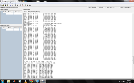

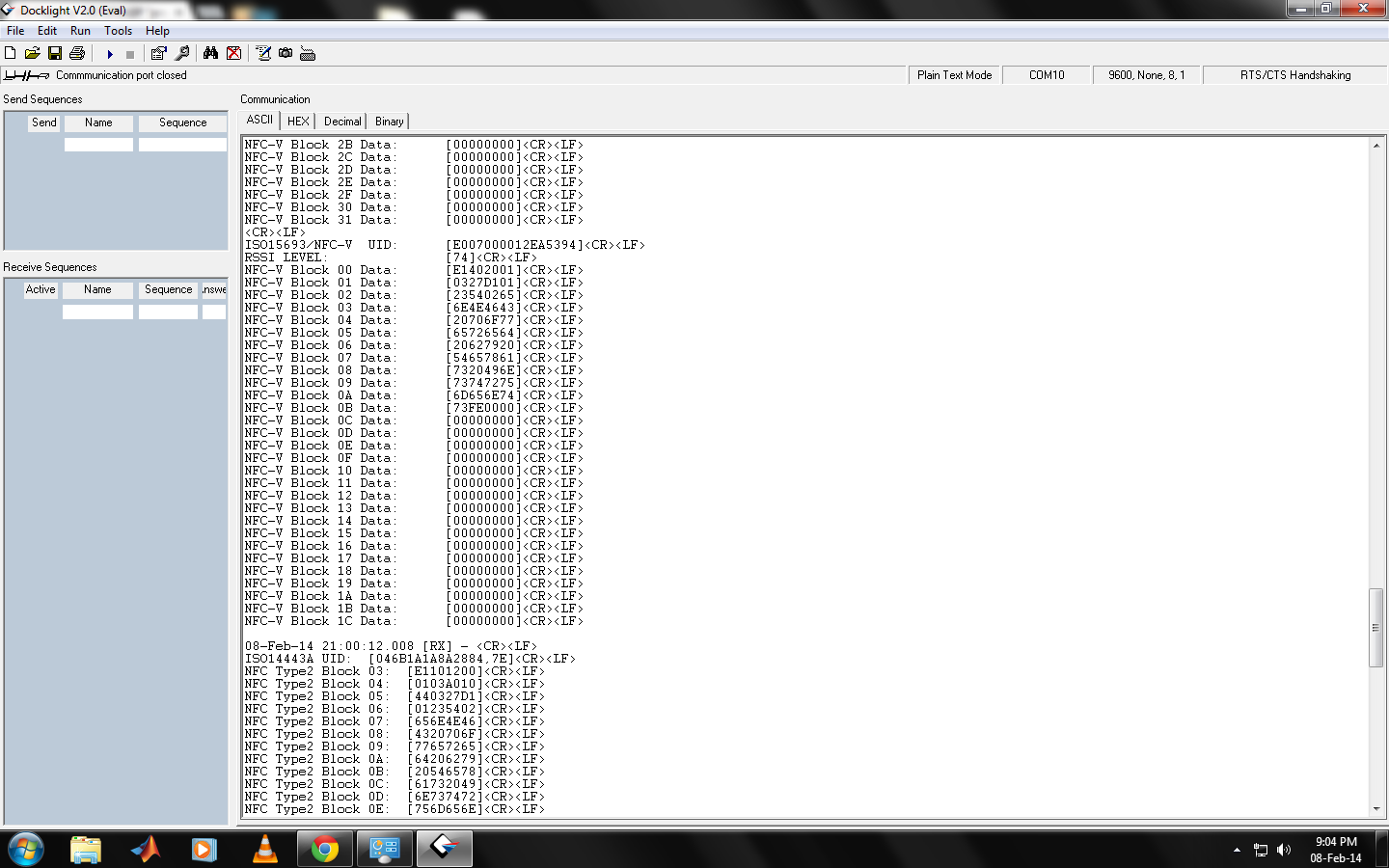

  • thank you for your help Sir..the output results are shown in the snapshot
