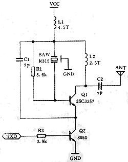

    First, why we expect to use async serial mode of CC1101:  we expect to use the CC1101 on our ARM9 board to communicate with some devices following 2262/2272 serial protocols, where serial bits streams in few kbps are modulated onto or demodulated from a 433MHz/315MHz carrier in a method of OOK. These simple devices are very cheap and popular in China market of security and smart-home industries.  If we could support 2262/2272 via cc1101 in our system, it will be more flexible than other 2262/2272 chips as well.  Attached please find some information about 2262/2272 and a popular OOK implemenation for your information. For your information, the PDF is a datasheet of 2272 chip. Please quickly examin the sections "code bits" and "code words" in pages 6-7 for packet format. And the JPEG is the schematic of how the serial bits are OOK modulated onto 315MHz carrier.6406.PT2272_Datasheet.pdf

  • Hi Yiming
    I will only comment on the packet format, and then I will have someone else comment on the rest as I am a SW engineer.
    It might be possible to configure the radio with a data rate equal to 1/α.
    A0 is 32α and is
    11110000 00000000 11110000 00000000 = 0xF000F000 (BIT 0)
    11111111 11110000 11111111 11110000 = 0xFFF0FFF0 (BIT 1) or
    11110000 00000000 11111111 11110000 = 0xF000FFF0 (BIT f)
    If the receiver knows what A0 is this can be used as a sync word, and the radio can be programmed to fixed packet length to receive the reminding code word (11 x 32 α) = 44 bytes.
    The 44 bytes can then be read from the FIFO and decoded back to 11 code bits.
    BIT 0, BIT 1, and BIT f are not very good sync words and you have no regular preamble, but it is worth a try.
