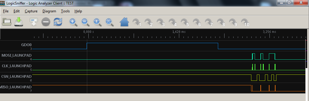

  • Finally, i can show you these signal with a new logic analyzer that i purchased:
    Now you can see that GDO signal goes on an I read TXBYTES and obtain ZERO than result of this operation...

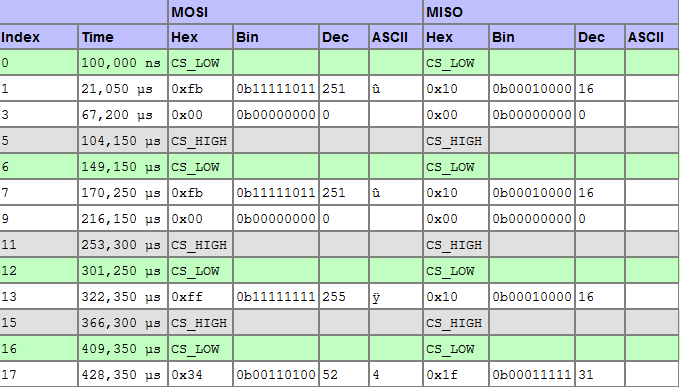

  • Hi
    I noticed from you SPI list that the returned status byte indicates that the radio is still in RX. This usually indicates that the radio has discarded the packet due to filtering, either address, packet length or CRC fault.
    The register settings you posted in the start of the post is a bit ambiguous. For instance; you have set an address for the device but are not using address filtering. You had also enabled the CRC_AUTOFLUSH without having CRC enabled (I know you have changed this later on).
    My recommendation is to do a test with default register settings exported from SmartRF Studio without any changes. Then send a standard packet that is within the FIFO limit, for example:
    0x05 0x01 0x02 0x03 0x04 0x05
    look at the GDO signal and check that the signals stays high throughout the entire payload and verify that the radio has gone to IDLE after reception. Then read RXBYTES and the RXFIFO content.
