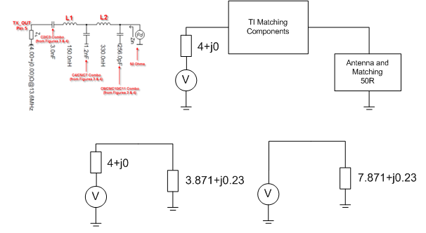

We are currently developing a product based on the TRF7970A. I have a question regarding the maximum output current of the antenna driver.
According to the datasheet the absolute maximum Vin pin current is 150mA and typically each supply is derived from Vin. Vin in our application is 5V and we connect VDDRF to VDDPA to provide the antenna supply (as per application examples).
Further down in the datasheet it says the maximum PA output current is 150mA. But there is also mention of 200mW output power capability (assumed into 50R which would be  63mA RMS).
Our antenna coil is a different geometry to the TRF7970A development board but the same inductance and therefore we have the same matching components.

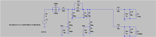

When we simulated the TRF7970A circuit we noticed that the output current from the chip is technically much higher than it is capable of producing (422mA peak).

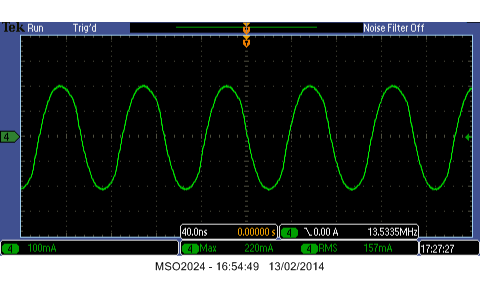

I have measured the output current on the TRF7970A EVM and found that it is 220mA peak (157mA true-RMS from oscilloscope):
Our circuit (with the same components) shows the same result.
I would like to know if the TRF7970A internally limits the output current to a safe level or if the circuit is operating out of its limits and likely to damage the IC over time.
The theoretical current in the simulation seems to hint that it should be much higher, hence the thought that the chip is limiting the driver current.
Current above is in R1 (from driver) and 427mA peak.
  • To add to the above, using the EVM the current from the driver pin is 212mA peak (156mA true RMS) with full power setting, 164mA peak (121mA true RMS) with half power setting.
    Is the EVM exceeding the output drive limit of the chip?

    It looks like you are using LTSpice to analyze your circuit.  One quick comment on your simulation is you assumed all ideal components which is not a good assumption.  Caps have parasitic ESR and ESL although the ESL is not an issue at 13.56 MHz.  Inductors have Q factors (real part) and winding cap.
    I don't have your simulation schematic visible but are you using the same Rx/Tx match TI used?  Also, how different is your "antenna" (actually inductor) to what TI used?

  • More questions: How did you measure the 212 mA peak driver current at 13.56 MHz?
    Also, have you put a thermal camera on the RFIC?  If so, what is the operating temperature when operating?
    Have you temp tested the RFIC and measured driver current?
    Eric
  • Hi Eric,
    Thank you for your replies. I appreciate the additional parasitics in the real-life circuit that are not present in the simulation. The circuit in the simulation is as per TIs reference schematic and I doubt if parasitics were taken into account during the design of that circuit as it would depend on the end user's physical implementation and component choice.
    In fact they show the derivation of their 4 to 50R matching network assuming ideal components and no parasitics.
    The current was measured using a TCP0030A 120MHz bandwidth current probe with an oscilloscope. I measured more or less the same current on the EVM as our product (they use the same matching circuit and planar coil inductance).
    I haven't temperature tested the IC as I usually like to confirm if I am overrating the recommended design parameters rather than see how hot it is getting on the bench. For example even if the IC is at a low/'safe' temperature I would prefer confirmation from TI that it is ok to pull more current from their output than the datasheet recommends. I am wary of designing off-datasheet!
    The simulation was used in an attempt to back up the theory that the antenna driver would potentially be trying to drive more current than is available at the driver output.

  • Further to the above.

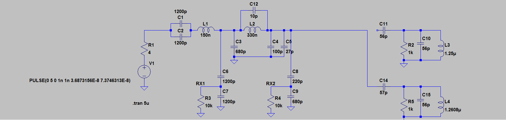

    The TRF7970A datasheet shows how the 4R output driver is converted to look like 50R looking back towards the driver. The antenna is matched to 50R so it looks like 50R looking toward the antenna.
    From a driver current point of view, if you take the antenna as a 50R load at 13.56MHz and work back the impedance that the driver sees looking out from its TX pin you end up with an impedance of 7.871+j0.23 (may have slight rounding errors due to my hand calculations!).
    In the above the 3.871+j0.23 is the impedance seen by the driver including the antenna.
    At 4V drive (the voltage at the driver vreg) you would expect to see around 510mA peak delivered to this load impedance. Hence the output driver of the IC is effectively overloaded.
    I have simulated the full matching circuit (as in my original post) using the true 50R matched antenna and a 4V source and I see 523mA peak from the source supply which ties in with the above derivation.
    So I still need to understand if this suggested circuit is actually overloading the output of the IC as it appears to be internally current limiting in the real circuit.
    The absolute maximum current on the Vin pin is listed as 150mA. The antenna drive is derived from Vddrf connected to Vdda, all derived from Vin.
    The datasheet says 'the maximum output current capability for 5V operation is 150mA'. I am not sure whether to take this as: it will self limit, or I need to design a circuit which doesn't overload the output.
    Mark
  • Mark,
    I think but I'm not 100% sure that the TRF7970A was designed outside the US.  It could be that the TI app engineers here in the US are looking for answers for you but don't have them yet.
    1. Have you measured the Vin input dc current and found that it exceeds the 150 mA abs max?  If not, please measure it and tell us what it is.
    2. What's weird is the abs max input current and the max input current in table 3.4 are both 150 mA.  I have found other issues with the TRF7970A data sheet like this.
    3. What does the TX_OUT voltage waveform look like?  It should be a square wave.  Also, what does the TX_OUT voltage waveform look like when you set the TRF7970A  to half power?  Post scope waveforms.
    4. Have you measured AC current of the driver when the antenna and it's match were replaced with a 50 ohm load?
    Eric Hooker
    RF/Microwave Consultant
    http://www.linkedin.com/in/erichookerrfconsultant

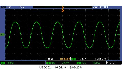

    Anyway, back on the main thread subject of the output drive. The Vin pin current is within spec - the trace below shows repeated reads with a small pause between each, around 80mA.
    The antenna pin current and drive waveform are shown below. Note the drive voltage at the pin is attenuated. It seems you can't accurately model the output as a voltage source with 4R load as it seems to have a more complex limiting structure. The current is 212mA max and 150mA RMS. The voltage waveform details can be found in the cursor box top right.
    I also measured the current waveform at the point of the 50R match to the coil:
    I will measure the current in the coil too. I can't really give you voltage measurements as the probe capacitance would distort the figures.

    I've looked at the match on a RF simulator.  I can post the results later.
    Eric
  • Meant to write: spectrum analyzer or a RF power meter.
  • Ray,
    Yes, I have already analyzed this circuit on a RF linear simulator.  I will post results in about 4 or 5 hours.  I have plans for the evening here in the US.  ;)

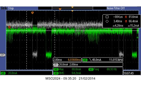

    2. The VDDRF regulator can supposedly supply 150mA to the PA according to the datasheet (smoothed by decoupling to some extent from a higher peak value)
    3. 150mA is less than the theoretical current assuming a 4R source to our matching components/antenna
    So for one I need to know that the above is ok.
    We also cannot accurately model the behaviour in spice because of this. For example it appears the VDDRF regulator is scaled down to 4V feeding the PA. We do not know if TI add series impedance or control the turn-on of the mosfet to limit the current.
    We do know that they can provide different modulation depths to the transmitted signal so they must be able to dynamically control the drive strength on the output pin to a higher level.
    I have read that the TRF796x range turn on their output during the start-up sequence to automatically adjust their internal regulators. Presumably this is done for 'max power output' setting. If I measure VDDRF output voltage it is 4V so clearly the IC has scaled its output drive down because of the load on the output. Interestingly this is below the minimum setting of 4.3V.
    I can confirm that the chip is in fact at full power for all of the measurements to date. If I switch to 'half power' mode then the input current drops a bit:
    (white is Vin pin current full power, green is half power)
    I don't think you can use the expected currents in the datasheet unless you really know for sure how they are measured. I am trying to make the point that the theoretical load is greater than expected which could completely distort measurements by distorting the output driver and the resulting input currents.

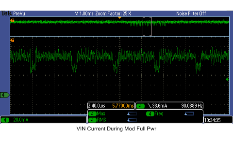

    FYI, note in the above the change in green trace current just after centre. These dips in current are due to the output modulation talking to the tag as the IC increases the output driver impedance to reduce its amplitude. There is approx 5ms delay before this which was a coding error and been reduced to 500us now.
    You can see below the Vin pin current when the output modulates data to the tag dipping with the modulation.
    Interestingly we have the TRF7970A set to OOK but it appears to be amplitude modulating its output (looking directly at the tx pin) with around 50% modulation depth. This is another issue to look at - I would expect the output to be gated on/off for OOK.

  • Hi Mark,
    I have read the entire post and I have encountered the same problem as you to get a TX model for LTSPICE. Have you received any news/answer?
    My schematic is similar to yours. The only difference is that I consider 4ohm resistance as part of the source voltage , so that for a voltage V1=5V, the measured voltage with the probe is about 2.5V, due the internal resistance.
    Sorry, if my english is not pretty good.

  • Hi Josh,
    I apologize for resurrecting this ancient discussion... and I appreciate that you've posted the LTSpice models that you use, but I am now fully confused.
    The datasheet claims that the TRF7970 should have an output power of 200mW but using the spice models you've posted I see much higher output power (around 600mW).. Could you explain?
    I read through all of the previous posts on this thread contemplating how the drive circuitry actually works to get to 200mW, but it seems that the LTSpice model you shared show that it doesn't? Or maybe I am just confused.
    Thank you,
    Eric Horton
  • into 50Ohm load, we would look at the Vpp and resulting calculated Vrms, then calculate power from there.
    so on slide 9  of the attached. you will see we measure about 9.6Vpp, which calculates to 3.39Vrms
    using P = Erms(squared) / 50 = 0.230W or 230mW, or 23.617dBm  - OK?

  • Okay that makes sense as far as output power from the coil is concerned.
    I am making my own PCB based coil for the TRF7970A and I was trying to determine what kind of current range I should be seeing on TX pin to ensure that I am not damaging the IC.
    Would you just suggest measuring outputs from the evaluation board/LTSpice model and then just comparing to my prototype? Or is there some limit that the TX pin should not be driven past (couldn't find on datasheet)?
    In other words: Does the TX pin have some maximum output current that it regulates itself too, or could a mismatched antenna damage the IC.
    Eric
  • a mismatched antenna would possibly damage the part over a long period of time, but you would catch it well before that because the main symptom that would manifest would look like firmware problem - i.e. you would have poor performance that may look like the interrupt handler is broken, etc.
