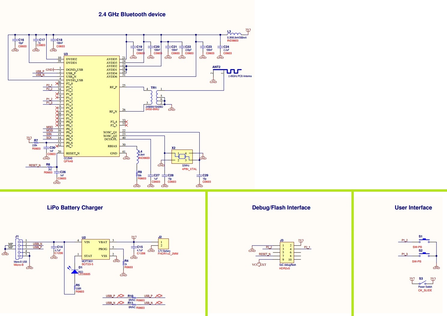

I have a custom PCB with a CC2540 and I am trying to modify SimpleBLEPeripheral.  I have two buttons on the board at P1.2 and P1.3.  The SimpleBLEPeripheral firmware with the Keyfob build has two buttons, one will switch advertising on and off.  The Keyfob buttons are connected to P0.0 and P0.1.  I'm unsure how to change the code to set the buttons up on P1.2 and P1.3 instead?

I'm guessing I need to change this code but where do the 0xFC, 0xFF etc. come from?  How can I work out what 0xXX I need to have P1.2 and P1.3 set as input?  I have spent hours reading the developers guides and searching the forums but I'm lost.

Edit with the pic of the schematic
  • To config P1.2 and P1.3 as GPI, you need to set P1DIR=0xF3
  • Thanks YiKai, but where does that 0xF3 come from?  How can I find this myself for future?
    Also what do I need to set the P1 = code to?
  • Okay I've just realised the hex to binary connection.  So 0xF3 = 11110011 which is all pins except 2 and 3 set to 1 for output and 0 for input.  I took that into account with setting the pin power too.
