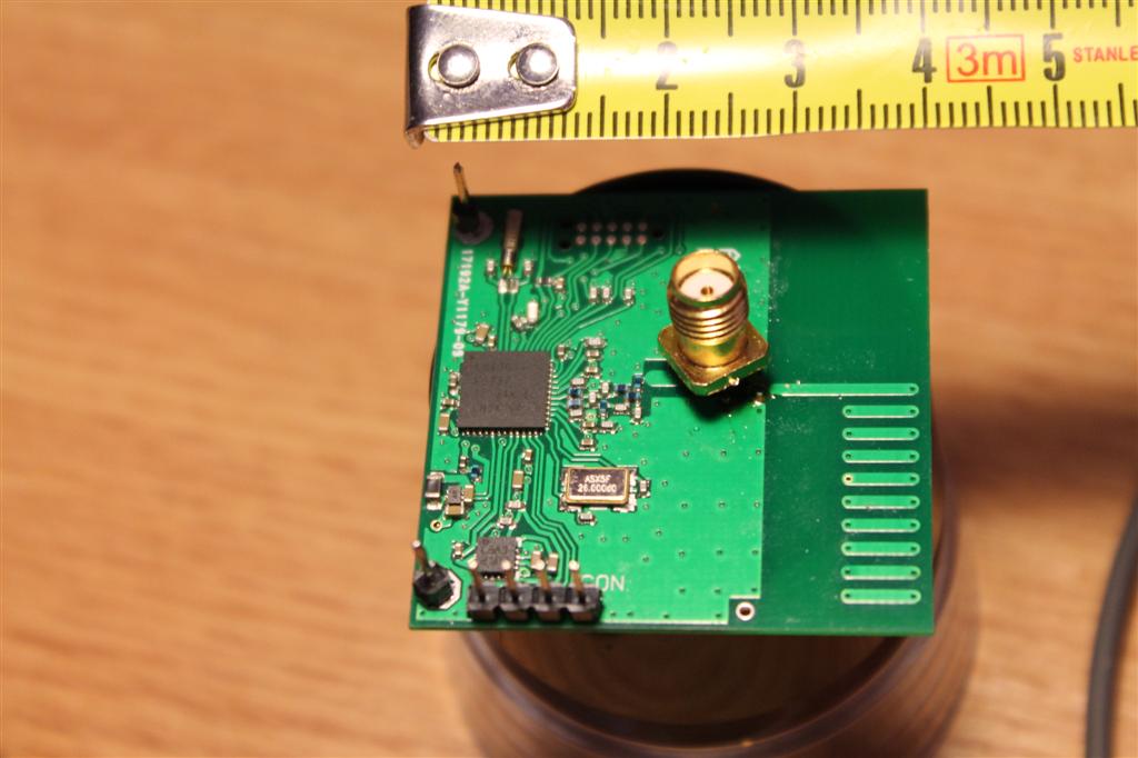

I asembled my first board using cc430f5137 and I'm testing it using smartRF studio and another board from TI (EM430). At 38 kbps the RSSI is -38dbi and the packet error rate is 64%, quite high. what could be the cause of the high Per? If i do the same test with two Em430 boards the PER is almost 0 so, I dont' supect external noise to be the cause. I'm not experienced at all in RF tunning.

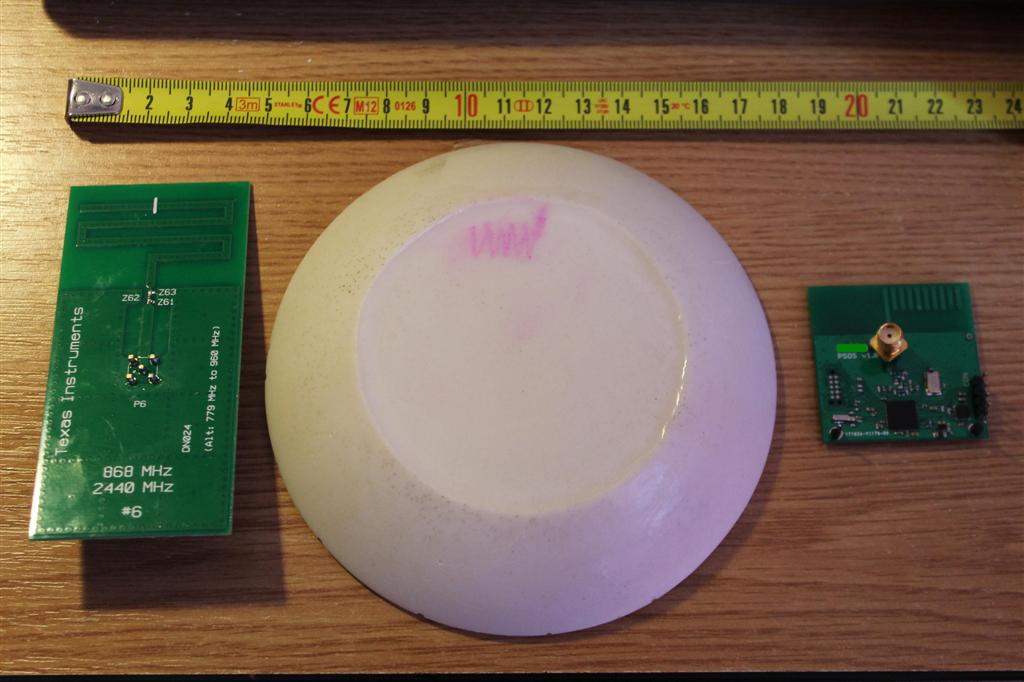

  • Hi, I tested these days different scenarios and the results are not satisfactory. The range is insufficient compared to the antenna #6 from the Antenna dev. kit. The RX performance is ~90% and TX is somewhere between 70-80% compared to #6.
    In the docs it is stated that the performance levels of these two antennas are nearly the same. Do I need to fine tune the antenna?
    I red a lot regarding antenna tuning but since I don't have a network analyzer my possibilities are severely limited, any advise would be very helpful.

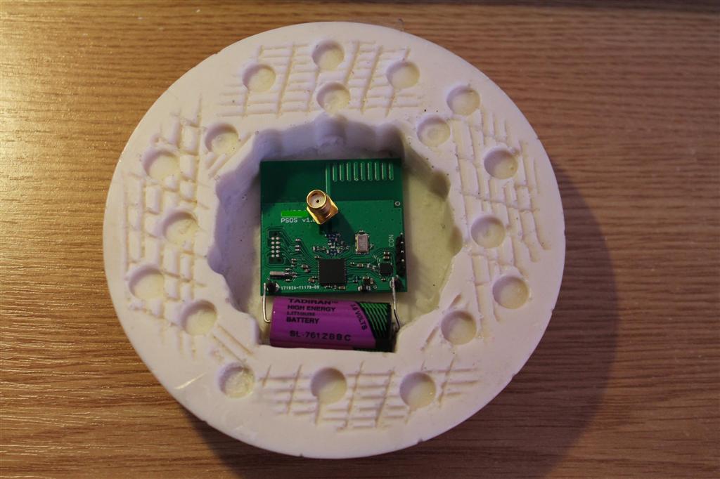

  • Sorry for the later post, edited: The product is a parking spot occupancy sensor, The physical volume/form factor is a cylinder with radius 7,5 cm (this can be changed) and height no more than 2, 4cm. The PCB will be potted in epoxy.
    Dragos
  • When putting your board in an epoxy, you will detune the antenna and move the resonance frequency. The size of your ground plane will also affect the resonance of your antenna. Have you looked at AN058  http://www.ti.com/lit/pdf/swra161? I understand you do not have a network analyzer, but you could try sweeping the frequency and look at the output power. Have you tried the kit antenna (whip antenna)?
  • The are some physical constraints which in this particular case cannot be avoided. But in the same time I'm not asking for the maximum range obtained in line of sight. What I need is 50m range which is achievable with antenna #6 with 0% PER in very harsh conditions (thick plastic cover, under a large car in a crowded street). The RSSI in these conditions was 85dBm at 9.6kbps.

    The whip antenna is used on one side, on the other side (sensor side) I cannot use it since the physical dimensions are impossible to fit.
  • Can you do a larger freq sweep? Do you have a picture or something of your board? So we could see how your board looks like and also one of the casing? Have you tuned the antenna at all or kept it as is? Have you done conducted testing? Have you tried other antennas as a reference?
  • The board has now a SMA connector attached, I'll try to do some tests with #6 antenna and I will post the results here.
    The enclosure for the prototype is made from polyurethane, the final shape and material could be a bit different.
    I did't tuned the antenna, the matching components are as indicated in the swra416.pdf: ANT2=1pF and ANT3=12nH

  • Yes, I did mean a finer resolution for the freq sweep, sorry for not beeing clear. Since from the RSSI values you gave the antenna did not look too bad, but I see that you have a completely different size on the gorund plane and with the casing, I would expect the antenna to need some different tuning components. Do you have a whip antenna from our kits you can try?

    Today I built another board, I did some tests, I'm puzzled a bit because when I'm testing the board in a concrete building with three walls in the middle, the board actually behaves better (2-3 dBm) than standard EM430... with whip OR #6.  I believe that, due to it's smaller size, this board get's de-tunned much easier that the others when I put it on ground, under a car and in a plastic encapsulation.
    Should I continue with it or should I switch to #6 which seems that it can deliver what I need?
