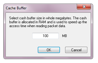

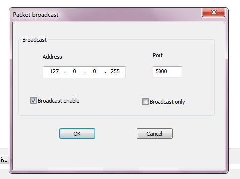

    I have solved the problem  in a very weird way. I had to change some options in the settings tab, but i dont know which one was:
    Toggle "Broadcast enable"
    change buffer size from 20MB to 100 MB (arbitrary):
    Anyway, that has solved the problem. Thanks for your answer!
  • I agree, very weird. Good that you got it working, though. It must have been one of the configuration parameters of the tool that prevented proper display, and the fact that you modified some of them reverted that particular setting. I assume you didn't try to delete the registry keys for the tool?
    Note that if you had selected "Broadcast only" in the "Packet Broadcast" dialog window, you would not have seen any packets in the GUI.
