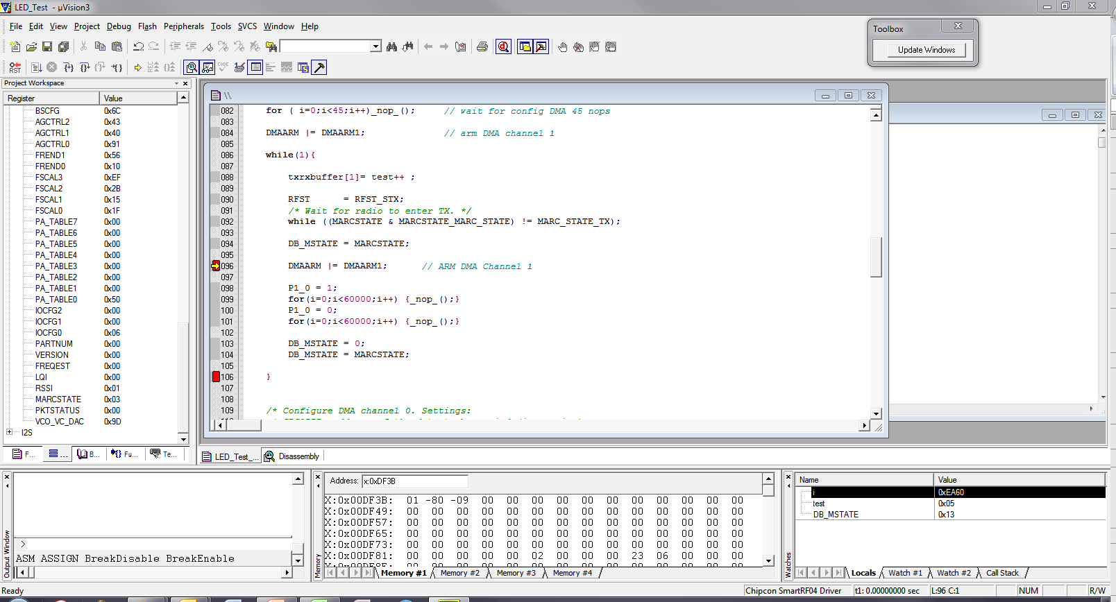

  • Hi, find attached the screenshot of this phenomena.
    XDATA window shows sometimes the right value sometimes not, I'm not sure if there is a contninous refresh ?
    The register on the left side normally will be refreshed after a value change. The variable DB_MSTATE shows every time the expected value of MARCSTATE.
    It tooks a long time that I recognized, the radio works well, only the showed register value is wrong.
