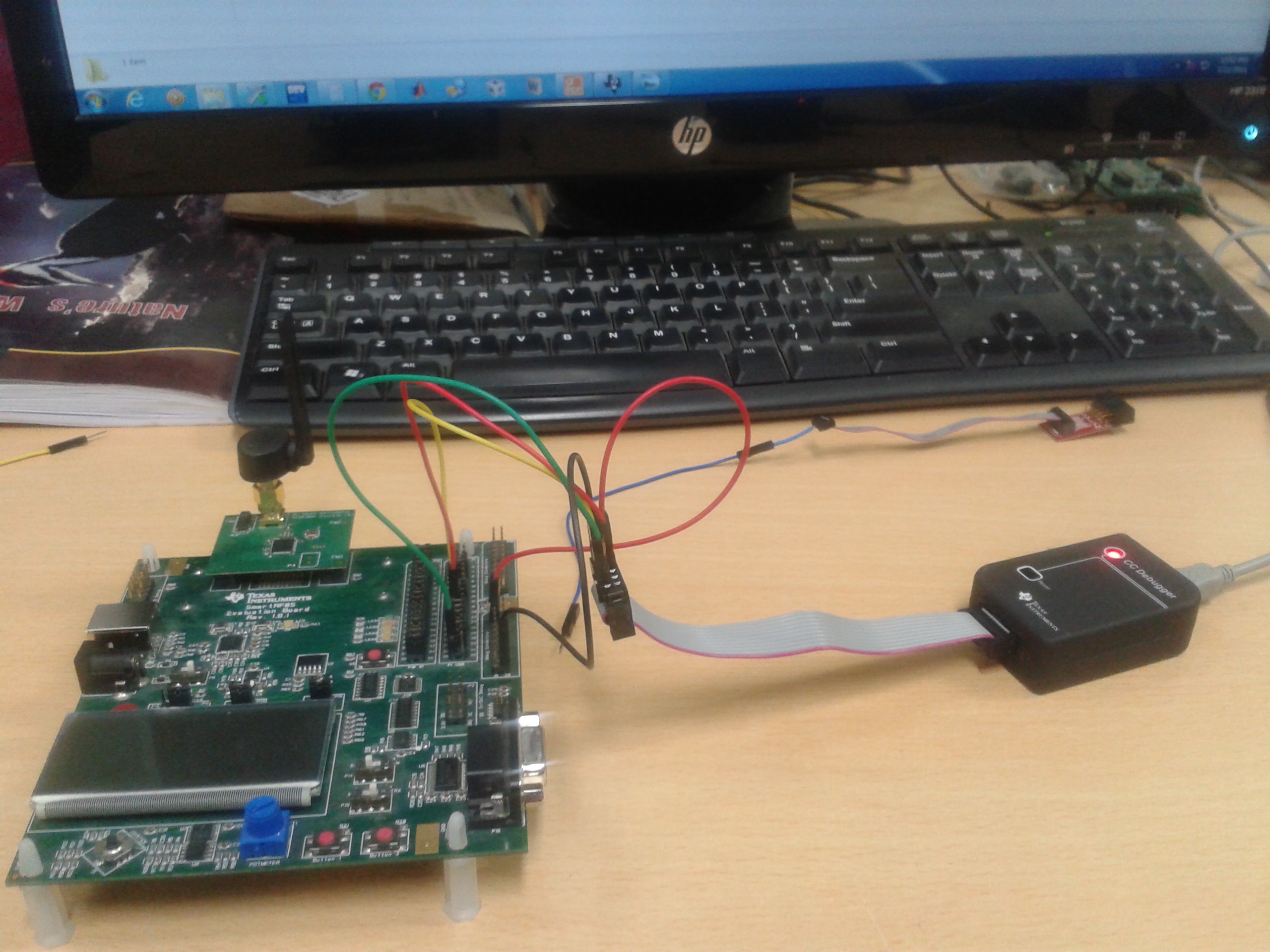

  • Hai M,
    i made connections as you told, but still i am getting RED light on in CC bugger.
    i am attaching snap of my set up.
    What is wrong in my setup..??
    Why it showing RED light.
  • You're apparently not supplying any power to the EB. Either attach batteries to the EB or connect pin 9 and pin 2 on the CC Debugger's target connector together.
    Also verify the reset signal. It should be on P10.35 (not P1.35).
  • sorry, that snap i took when i power was off.
    even when power was on(i am giving from batteries) also its showing RED light on CC debugger(i.e no device was selected).
  • Hai M,
    i observed one thing is, when i connect  pin9 of CC debugger is P11.1(Port 11 of 1st pin), The LED is going to OFF mode.
  • Debugger Target Connector  <---> SmartRF05EB
    Pin 1 to P20.20
    Pin 2 to P20.3
    Pin 3 to P1.19
    Pin 4 to P1.21
    Pin 7 to P10.35
    Power the EB from USB or batteries, alternatively connect pin 9 on the debugger's target connector to P11.2 to power the EB from the debugger.
