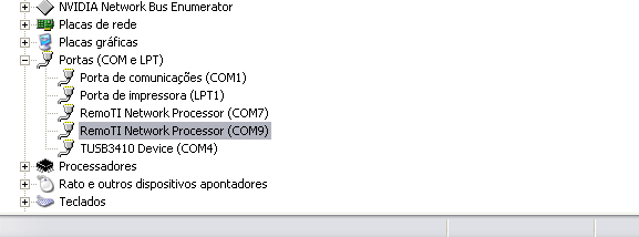

    I did strictly what you told me to do. I flash CC2531F256_HEX configuration RNP project using SmartRF Flash Programmer after adding ZID NANO DONGLE as a symbol at project. Then I installed the driver. And it was recognized as COM9 in my PC.
    On this stage it seemed like everything were ok:
    COM4 - Target module - correctly communicates with Windows Form TV Emulator Application
    COM7 - CC2531 dongle - correctly communicates with Windows Form DVD player Emulator Application
    COM9 - CC2531 nano dongle - for Windows Form STB player Emulator Application.
    Before develop Windows Form STB Emulator Application, I tested my RNP nano dongle with the Windows Form TV Emulator Application but using COM9 instead of COM4.
    But RTI_ERROR_SYNCHRONOUS_NPI_TIMEOUT erro still occurs at configuration parameters when I call RTI_WriteItemEx. I have tried many ways to solve the problem but
    nothing solved the problem. And it is not a problem from my Windows Form Application because it works correctly with others RNP, through others COM port.
    I don't know what you can advice me about this problem.

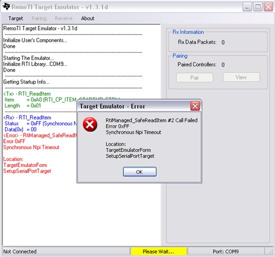

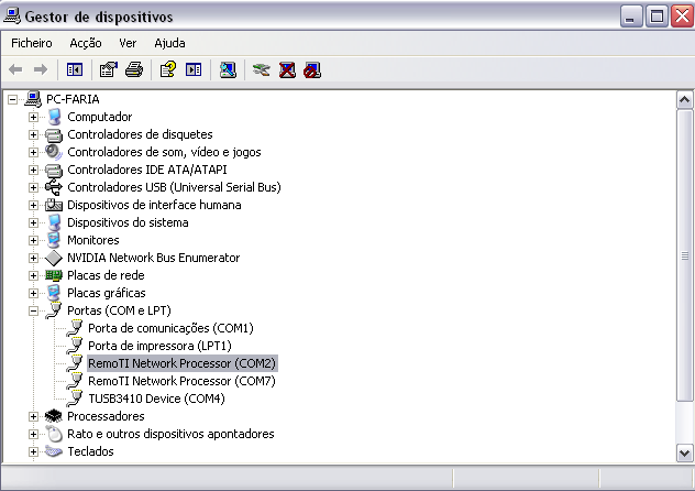

  • Hello Jose,
    Thank you again!
    I tested the Nano Dongle with Target Emulator and Target Emulator was blocked for some seconds, then occured this error:
    The others RNP (COM4 and COM7) are working correctly with Target Emulator.
    I tried to assigning another COM port to Nano Dongle, I changed it to COM2. But the error shown in the first picture is still occuring.
    Jessica Inocencio
  • Hi Jessica,
    I think that I know what the problem is. You need to define the symbol ZID_DONGLE_NANO, and I wrote in my previous post from last week I wrote ZID_NANO_DONGLE, when it should be ZID_DONGLE_NANO. My apologies for the misspelling.
    I've attached an image that you can flash to the nano dongle which should work
    http://e2e.ti.com/cfs-file.ashx/__key/communityserver-discussions-components-files/159/3443.rnp_5F00_cc2531f256.hex
    Jose
