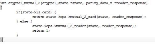

  • HI Josh,
    I am using MSP430F5510 (USB Controller) and interfacing TRF7960A RFID Reader. As per the above shared code i have copied/implemented same. But in direct mode 0 it is not working properly.
    When compared MSP430F2370 with MSP430F5510 difference is only using 8MHz crystal as the Clock because for working of USB communication.
    In this loop its getting into else loop  in crypto 1
    and not returning from there, can you please check and let me know
