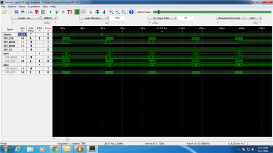

    Do you reset the FIFO after getting the TX complete IRQ? Do you have any logic analyzer shots to share from your system?

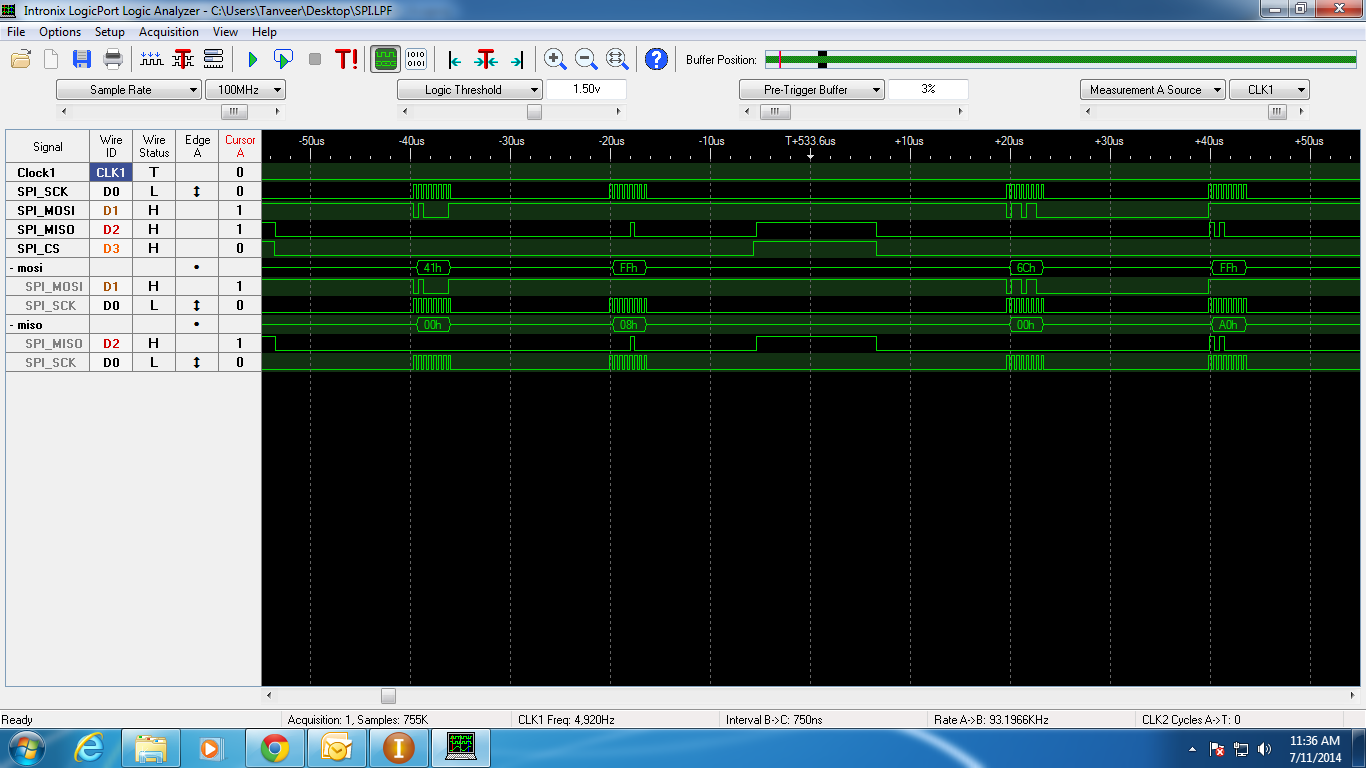

  • Hi josh,
    it means after running the anti collision loop i am getting 0x88(first byte) and 3 UID bytes these are : 0x04, 0x1F, 0x1C and 1 more BCC byte which is 0x8F.
    But still i was sending them correctly if i send these like this SELECT + NVB + 0x88 + 4 byte because i am sending 3 UID bytes combined with1 BCC byte
    which is: 0x8f, 0x91, 0x3D,0x00, 0x70,0x93, 0x70, 0x88, 0x04, 0x1F, 0x1C, 0x8F
    And after sending these i expect TX complete and RX Complete IRQ. but it doesn't happen TRF7970A sends me interrupt before the complete TX.
    I am sharing with you screenshots of logic analyzer.
  • Tanveer -  go ahead and send over the *.LPF file - we have same LSA

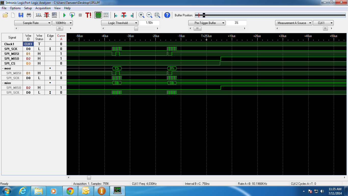

  • Hi Josh,
    I have attached *.LPF file.
    4426.SPI.zip
  • do you have one of entire thing (including writing of registers), plus IRQ line? you should be using it. what i see here is you poll the IRQ until you get 0x80 but then don't do anything afterwards.
    plus what is your data clock speed
    i was expecting something more like this:

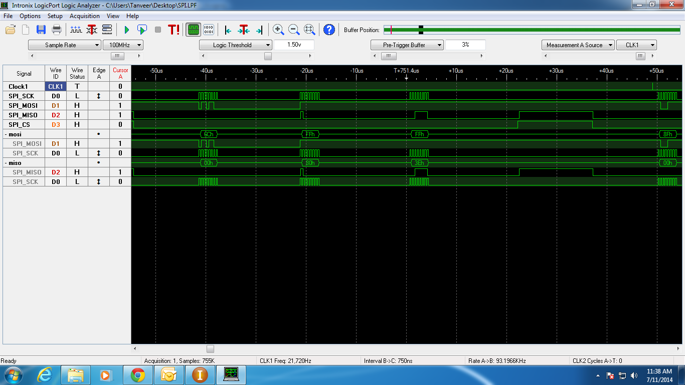

  • Josh,
    I have written these settings in registers.
    0x00(Chip status control register) :   0x20 (RF on and 3V operation)
    0x09 ( Modulator control register)  :   0x01(  not using SYS_CLK and 100% OOK)
    0x01(ISO Control register)              :   initial 0x88 and after runing anti-collision loop 0x08
    After receiving I also wait for the RX complete IRQ. But i didn't get RX IRQ.the DATA_CLK value is 2 MHz.
    I have also attached the*.LPF file with IRQ details.
    1258.SPI.zip
    I can conclude now that after running anti collision loop and transmitting SELECT +NVB + 0x88 + 3 bytes UID + 1 BCC byte, TRF7970A only sending TX IRQ and it is not sending antoher IRQ for RX IRQ. but why it is not sending RX IRQ?
  • The problem is  resolved now.
    "Earlier i was simply by passing and not clearing the interrupt bit of MCU when i was getting status (0xA0) after transmitting SELECT + NVB + 0x88 + 3 UID bytes + 1 BCC byte. Because of this,interrupt handler runs again and   this time i was getting status 0x80 (which means TX complete).But In between of  this,RX complete IRQ was getting lost and i was never getting RX complete IRQ."
    Now i clear the interrupt bit  of MCU even when i was getting status 0xA0 of IRQ status register of TRF7970A. And after doing this i am getting three IRQ.
    At first IRQ status is 0xA0(means TX active).After this i get second IRQ and status is 0x80(means TX complete). And after this i get third interrupt and now status is 0x40(means RX complete). And now i am getting SAK.
