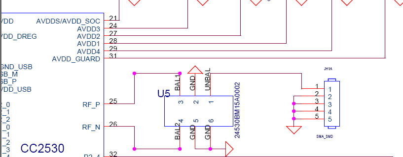

    I have removed the discrete components at the RF part for CC2530EM and put the balun 24530BM15A0002
            will it work fine..?
                  will it reduce the range of EM..?
    regards
    chethan
  • Hello Chethan,
    I guess you mean the 2450BM15A0002 (Balun from Johanson Technology), if you follow the reference design, http://focus.ti.com/general/docs/litabsmultiplefilelist.tsp?literatureNumber=swra297, it should work perfectly.
    This should reduce the range a little, as the link budget with the balun reference design is approximately 1.6 dB worse then the CC2530EM reference design (1.2 dB lower output power (TXPOWER=0xF5) and 0.4 dB less sensitivity).
    On the other side you would be less prone to layout influence as this balun design is very compact, which may improve performance.

  •  Hi,
    Yes ,I wanted to know about this part only 2450BM15A0002..
    I have designed the ckt with this balun,now i have got the PCB and all but i'm not getting this balun from any distributor.
    Can I use any other balun(which works in same frequency) for design..?
    if you know any vendor pls provide the details of them...
    regards
    chethan
    to my knowledge Digi-Key is providing the part from Johanson, however you can use other vendors as for instance Murata, Anaren, but these baluns are not made especially for the CC2530 as the Johanson balun so you might have to do some impedance matching.

    Due to unavailabilty of  the balun 2450BM15A0002(2.45 GHz Matched Balun / LPF: Optimized for TI Chipset CC2530 and 2531 P/N 2450BM15A0002)
    I have selected the following balun.
    pls let me know will this work fine with CC2530EM thanks.
    Sorry ,In the lost post I frogot to metion the part which i have select.
    Here is the balun
    Part Number :                        LDB182G4520C-110
    Frequency Range (MHz)    : 2450.0 ±50.0MHz
    Insertion Loss I)(dB)            : 1.3 max. (at 25°C)
    Insertion Loss II) (dB)         : .4 max. (-40~+85°C)
    Unbalance Impedance
    (Nom.) (ohm)                         :50
    Balance Impedance
    (Differential) (Nom.)
    (ohm)                                       :200
