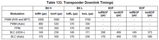

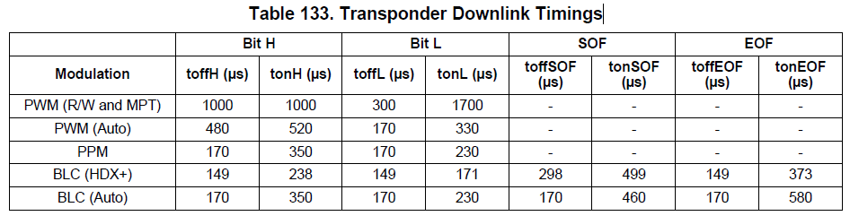

MRD2 Transponder Downlink Timings diagram
Other Parts Discussed in Thread: RI-STU-MRD2
Regarding the "RI-STU-MRD2" Downlink Timings,
"Table 133. Transponder Downlink Timings" in the reference guide
mentions about different parameters like toffH,tonH,toffL etc
but it is difficult to understand the proper position of these parameters.
Is there is any timing diagram which explains these parameters in detail?
And also we would like to know if there is any details
of the default values for MRD1.
