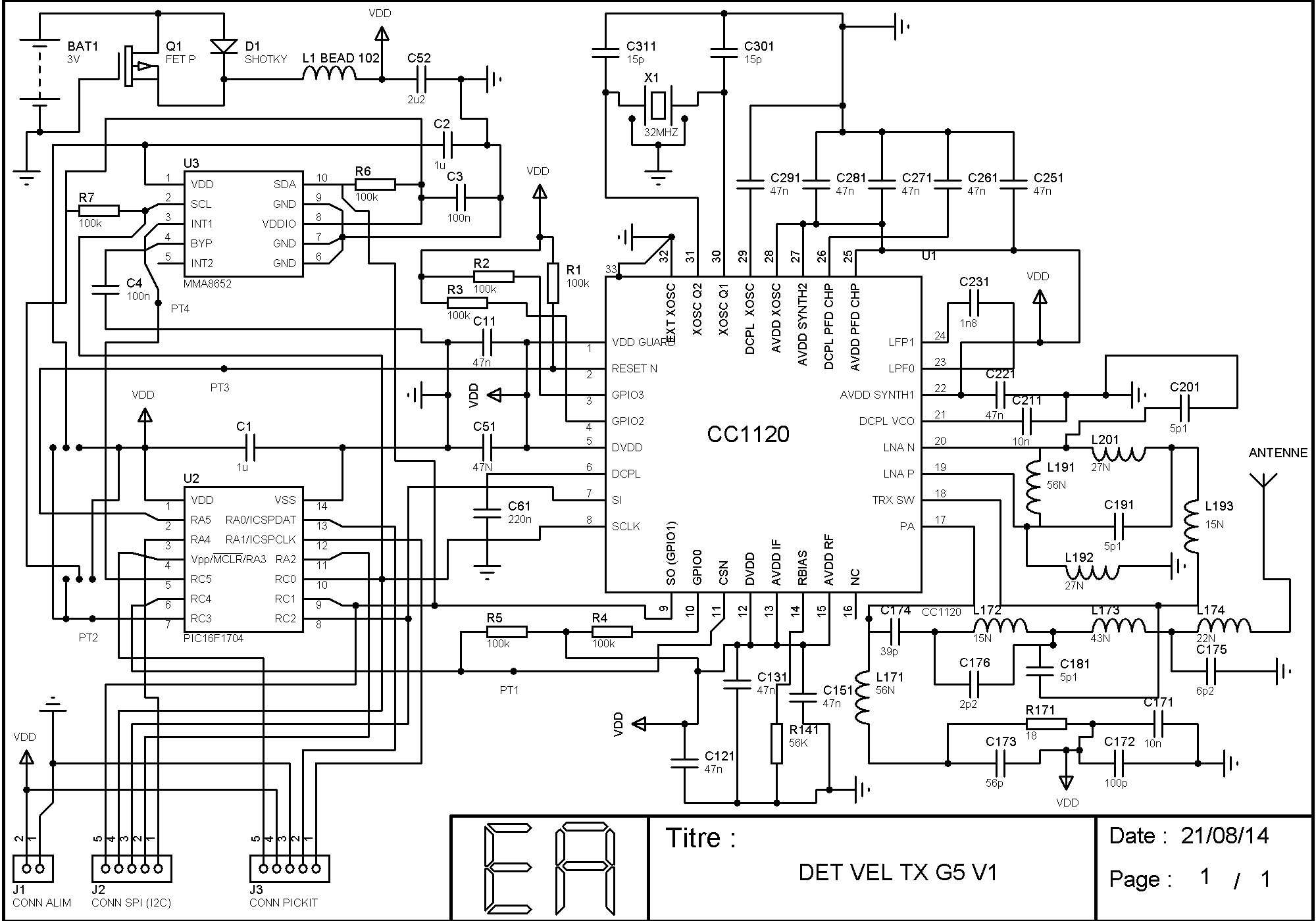

I'm designing a prototype board with cc1120.  There is a problem, with a 32 Mhz Quantek quartz, the cc1120 is not running.
So I decided to remove the 32 Mhz crystal from my CC1120DK_EM_420_470 evaluation board, and try tu use it on my prototype. And with this 32Mhz crystal my prototype is running well. But I cant buy this crystal easyly from my  providers.

  • The crystal oscillator is design to work well with most standard AT cut SMD crystals with the spec given in 4.14 in the datasheet.
    - What is the spec for the xtal you used originally?
    - Do I read your post correctly: Do you have issues on your design with the Epson xtal taken from our EM? If so, please post the relevant part of the schematic and layout?

    I join my pdf schématic
    It is difficult for me to send  the layout, because it is a specific file  in our CAO. But I think the qantek xtal and the 2 x 15pF capacitors are mounted well, very near the cc1120. Tell me if it is necessary, , I'll try to make a pdf file for you.

  • Do you have issues on your design with the Epson xtal taken from our EM?
    It would be nice with the the relevant parts of the layout too since the schematic looks ok.
  • Yes, with the epson xtal taken from the EM, all is ok. I send and receive good packets, and the rssi is ok. And when I remove the epson xtal, and mount the qantek xtal (and no other change), it is not running.
    I join the relevant part of the layer.
    layer xtal.pdf
  • The layout and schematic looks good. I suspect that the issue is a spec point for the crystal not covered in our datasheet. In an internal document I found the maximum C0 should be 2 pF and your crystal is 5 pF.
