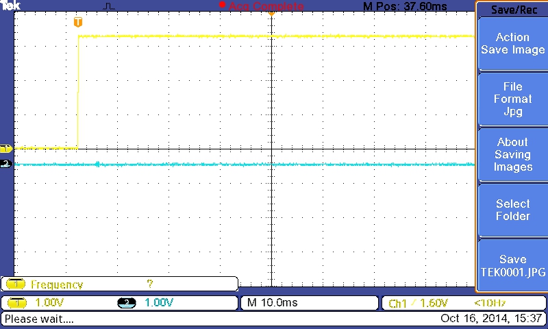

From user space i am using nfctool and the tag i am using is Tag-it HF-I
  • deep ter -
    can you do us a favor and capture your power up sequence and initial configuration (register settings) on o'scope or logic analyzer? and provide your schematic (section of the TRF7970A to the uP)?
    thanks!
  • Hi Josh
    Thanks for your immediate reply. We have fixed the issue of getting continuous interrupts at the boot time. We added a pull down in the interrupt line as our interrupt was active high.
    Regarding the initial configuration of registers. I did not make any configuration. Everything is made from the driver.
    I have attached the driver.
    From the user space when we call nfctool -p -d nfc0: (for polling)
    The issue we are facing now is that our RSSI value is not changing even after we keep the Tag near the trd7970a.
    We checked VDD_RF. That was also not showing any voltage.
    Even I am enabling the RF_ON bit B[5] in the CHIP STATUS REGISTER.(0X00).But when i try to read this value i am not able to get the same value.
    Kindly tell me how to proceed further.
    Attached is the power up sequence:
    Yellow line is EN
    Blue line :EN2
    Regarding the schematics we are now using the I.MX6 Sabresd board\
