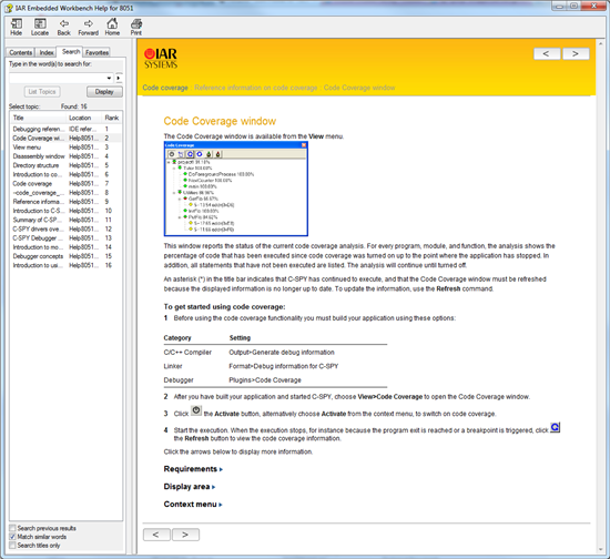

Does anyone use code coverage in the IAR Embedded Workbench for 8051? I'm trying to enable it but it is greyed out even though I've set up all the options to enable it. IAR systems wants $1500 to answer a question which seems a bit excessive.

I've done all this. Do I have to be using a TI evaluation board to run Code Coverage?
I can't even get there. The options for selecting code coverage are greyed out.
Strange. What device are you working on and what version of IAR are you using?
Try this example code
http://www.ti.com/lit/zip/swrc085
I'm able to run the Code Coverage with IAR version 8.30.1 on the CC1110 following the instructions given in the previous posts
