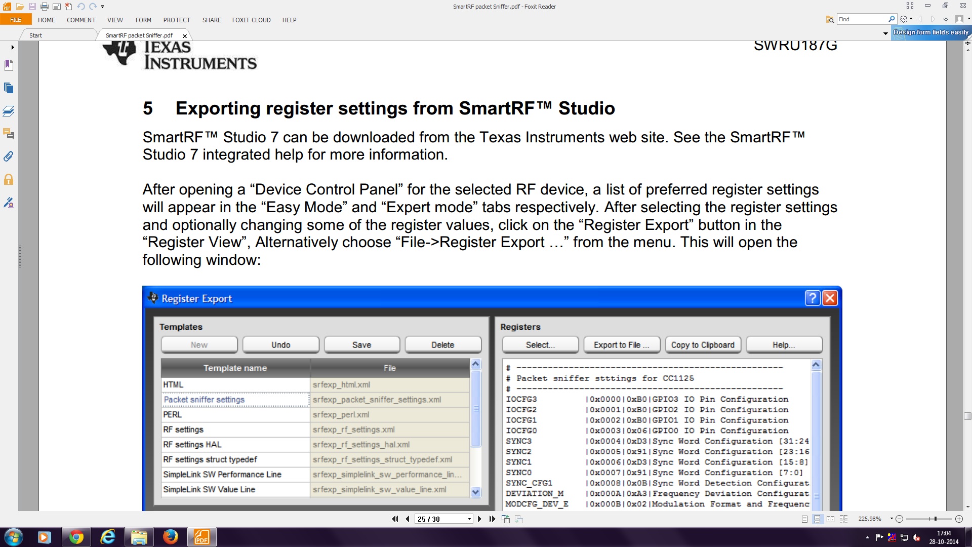

I'm using SmartRf05EB board +CC2530EM as transmitter and SmartRF05EB board connected with CC2531 USB dongle as receiver and i transmitted a fixed count of packets between transmitter and receiver using SmartRF Studio7 which has been done  sucessfully.Now I want to capture those packets of received data by using Packet Sniffer.
Actually when I had gone through the Smart RF packet sniffer user maual it is given that we need to export the register called Packet Sniffer Setting
but  in my case when ever i go the register export of device control panel of CC2531 i dnt find the packet sniffer settings template.
1 thing what i tried is i have exported RF settings and saved it as ".prs" file and opened smartrf packet sniffer software and in the menu bar File->open save data and opened the file which i saved it as .prs file.Is this procedure correct??
If dis is correct what is  the usage of play button over der which is used to capture packets??
Can u please guide me how to capture the packets from smartrf studio7 to smartrf packet sniffer in a procedural way.

  • Hi NA,
    CC2531 is a IEEE 802.15.4 device and the configuration of this device is different from proprietary devices. See chapter "2.6 Radio Configuration" in the user manual.
    In fact it's a lot easier. You just have to select the required channel. No export from SmartRF Studio is needed.
