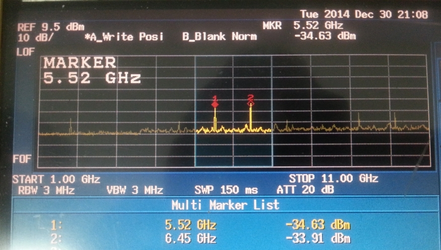

We made our own board with CC1110 and this board runs good at frequency range 917~923Mhz so far.
But recently we found there's unexpected sub carrier frequency at 5~6Ghz band been also generated when TX.
I like to know which can possibly cause this how to eliminate these 5~6Ghz sub carriers.

It's also generated when using SmartRF Studio and here's what I do.
(1) Open SmartRF Studio7, choose CC1110
(2) Choose Typical setting "Data Rate : 38.4 kBaud, Dev : 20kHz, Mod : GFSK, RX BW : 100kHz, Optimised for sensitivity"
(3) Change Base frequency as 919.1Mhz
(4) Run continuous TX
  • The spurs are the 6th and 7th harmonics of the fundamental.
    I assume you are targeting compliance with FCC 15.247 or 15.249.
    15.247: Requirement for 6th harmonic is -41.2 dBm. Requirement for 7th harmonic is -20 dBc.  The antenna has a finite BW and will probably attenuate the 6th harmonic well below the limit when you do radiated measurements. 7th harmonic is not a problem.
    15.249: Maximum output power is -1.23 dBm. Requirement for 6th and 7th harmonic is -41.2 dBm. The antenna has a finite BW and will probably attenuate the 6th and 7th harmonics well below the limit when you do radiated measurements. Note also the limitation on max output power.
