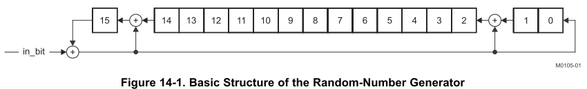

    Read more about the generator in the CC2544 user guide in section Implement in "15.1 Introduction". Below you see the LFSR structure:
    The period of the pattern (number of values before repetition) depends on the feedback taps and the initial state (seed value). For a 16-bit LFSR it is theoretical possible to achieve a maximum pattern size of 2^16 which is called a maximum length sequence or m-sequence for short (pseudonoise PN). But this only happens for a LFSR with a certain configuration for the feedback taps/polynomial. The polynomial describing the taps must be a primitive polynomial which the CRC-16 is not. Therefore the sequence length produced before repetition occurs will be less than (2n-1) where n is the number of bits in the LFSR.
    For a general implementation to find the period of the pseudo-random pattern see my suggested code thtat follows. I have not tested it so there is a chance there is an error. By doing this you can find out how long the sequence of numbers are before it repeats. But for each clocking the LFSR is shifted 13 times meaning that you will need to perform the operation below 13 times and then read out the LSB (bit0 to bit 7 in LFSR) to get the values that are produces in the CC2544 application. So you can then divide the pattern length by 13 to get the actual sequence of pseudo-random bytes if you only read out the least significant Byte from the LFSR.
    A few notes to consider also is that 0x0000 or 0x8003 always leads to an unchanged value in the LFSR meaning that you will get an infinite sequence of either 0x0000 or 0x8003. When using the LFSR in random generator mode the LFSR will be unrolled 13 times for each clocking operation meaning that you will need to run the procedure within the do-while (seen below) 13 times before you read ou the least significant byte to get the same values as retrieved in the CC254x application.
