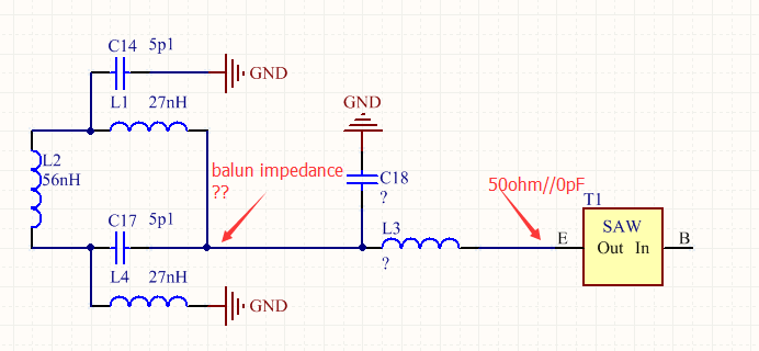

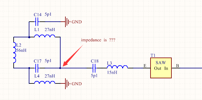

Hello, we just follow the reference design <420  -  470MHZ>, now we like to insert a SAW filter <output Z=50ohm>  , so we need to design a match network between SAW and the BALUN ?  so what the impedance on BALUN input?
directly to use C18 / L3 is ok, no need to design a match network ???
