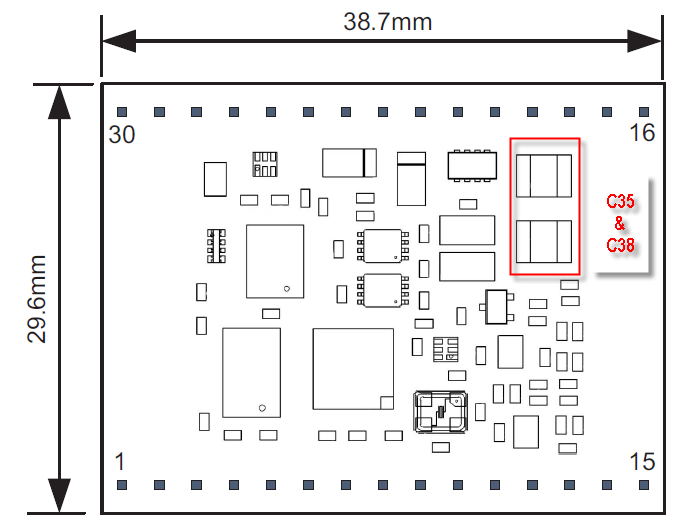

    also, the tolerance of the capacitors you are asking about which will make the 30nF (in positions C35/C38) are +/-5% (C0G)
    C35 / C38, where do you have pointed to as?

  • Hamada -
    please see picture below for the locations of the tuning caps on the board.
