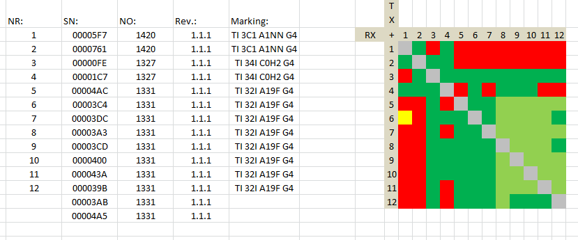

So i tried the direct communication between the EMK Boards. We have at least 12 EMK Moduls and i notice some disappointing behavior.
I tried every modul as RX and as TX part with all the other moduls. Also used a FR5969 (TS430RGZ48C) and the SOC_BB to mount the EMKs.
Green = the Paket received successfully.
Red = the Paket is corrupted or nothing was received.

So before i got more frustrated by searching the design flaw in my layout... is it even possible to communicate with one of the EMK Moduls?

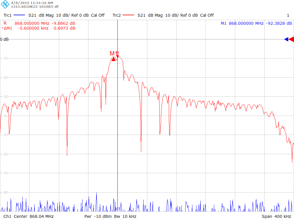

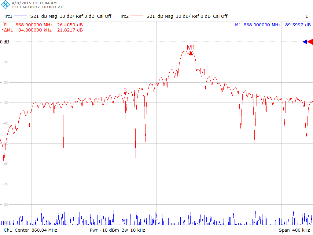

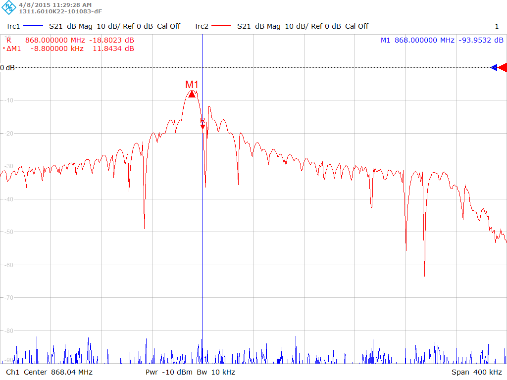

  • Check if there is a significant frequency offset between units which cannot communicate. Use a spectrum analyzer to measure the frequency offset and account for this when configuring the CC1120. If you do not have a spectrum analyzer one test would be to increase the RX filter BW and/or enable FB2PLL (see user guide, set FREQOFF_CFG = 0x30).
  • Hello Sverre,
    thanks for the hint! I organized a spectrum analyzer and the output frequency has a offset from approximately +70kHz. I increased the RX filter BW from 10 to 200 kHz. Nevertheless, many packets failed at CRC check. I adjusted the Carrier frequency (-70kHz) so it matched the 868 better, this seems to be the best soulution.
    Is the offset just dependent on the crystal inaccuracy and the RCL stuff?

    The 70kHz was with the EMK (EMK10)  and my Crystal+pF.  Attached my Meassurements:
    EMK 1:
    EMK 3:
    EMK 10:
    EMK 11:
