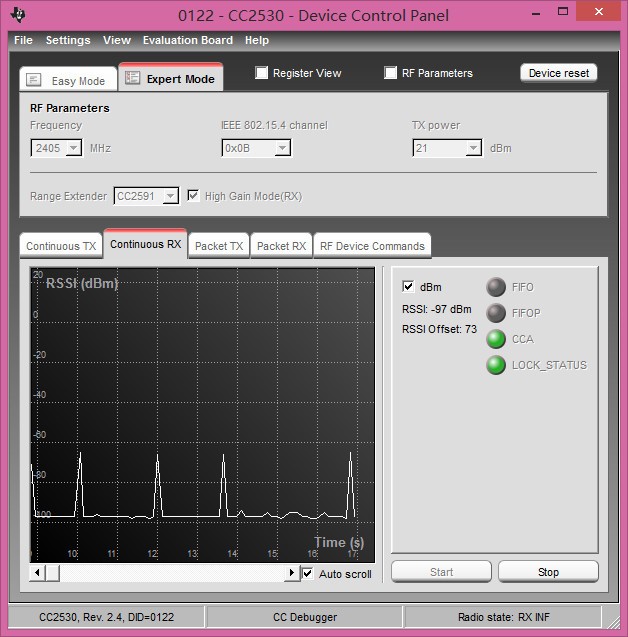

hi ,
     there are two device , one is ZED which was always in searching network
     the other one was connected the CC debugger to the PC ,and open the smartRF studio 7  Continueous RX window, as below
     there are so many question about this process
    1. nomatter  what value of  Txpower  i had set , there is nothing different happen in the Continueous RX window
    2. when i turn off the ZED ,stop searching, and there are not any more devices, The Continueous RX window also could catch something
    3.what is the highest value in  Continueous RX window ,is that  real searching network signal?
    4. how could i catch  the RSSI value in real product working moment
BR!
  • If you are interested in the RSSI for a received signal you should read the RSSI from the RSSI register for a received packet.
    The peeks you see in the SmartRF Studio window is the packets your sender is sending but the time resolution is low hence it's not possible to get the accurate RSSI when receiving a packet.

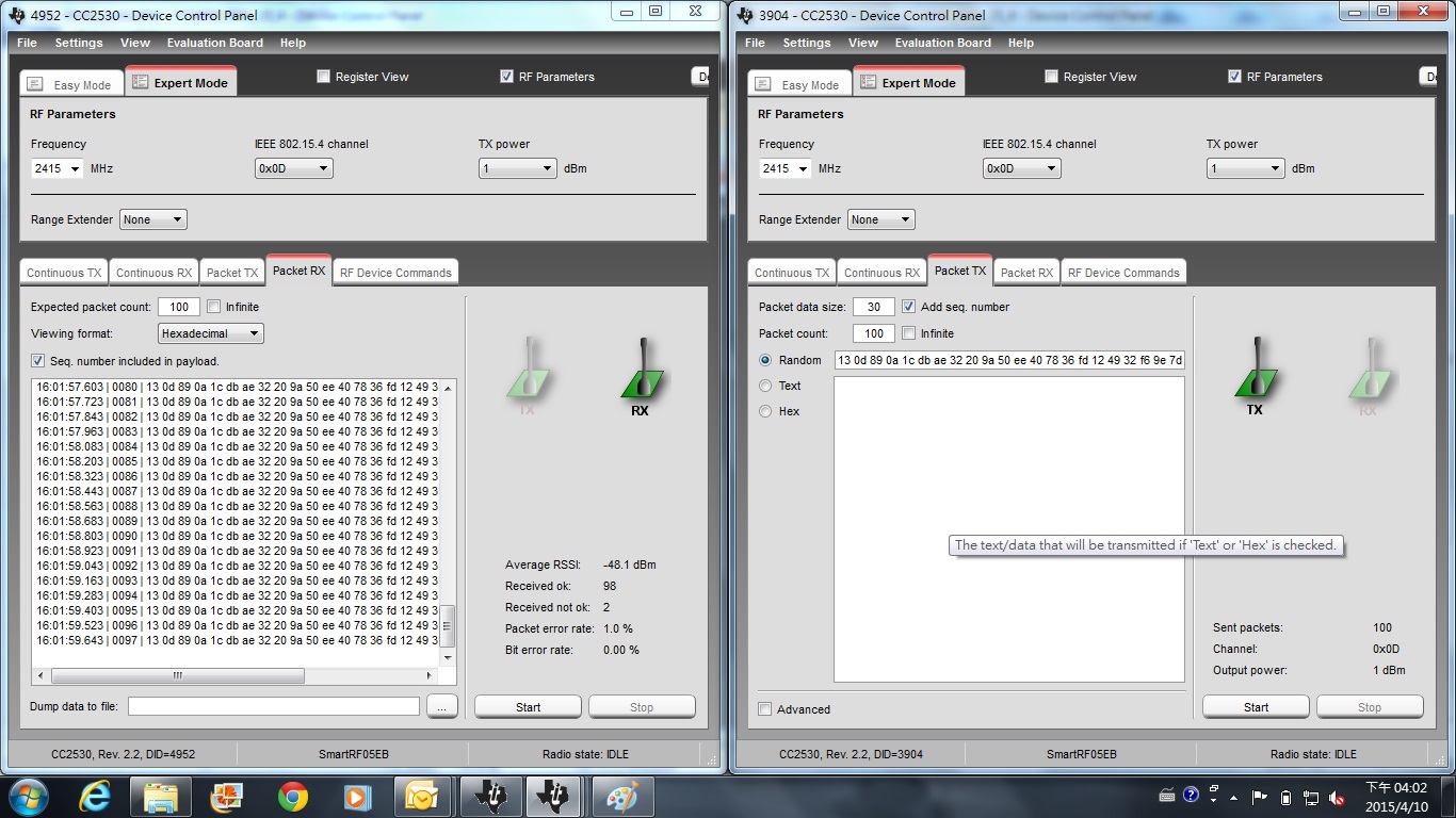

  • You can use one CC2530+CC2591 which applies Packet TX on SmartRF studio 7 and another CC2530+CC2591 which applies Packet RX. In this way, you can see RSSI and PER.

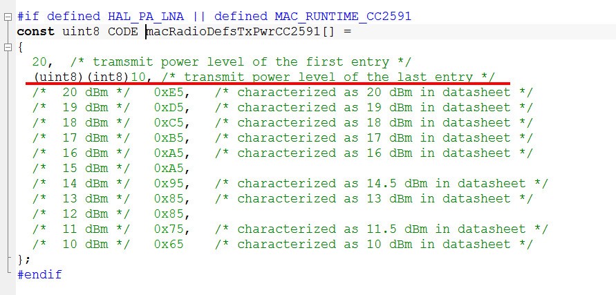

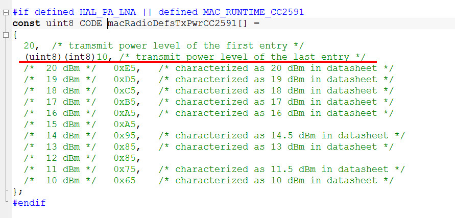

  • but i am always didn't know  what is the meaning of the item in the TXpower setting function。
    as coding like “macRadioSetTxPower(21)"  , what is the meaning of  "21"
    is that the real value of dBm? if it is , how could we set a minus one ?  is  that ok coding like this ” macRadioSetTxPower(-11)"  “
    or is that was only the  index of  the TXPOWER table ?
    but I saw the TXPOWER table as like below , ”21“ could not fit for anything~~~~

  • 21 in maxSetTxPower is dbm. You can only use dbm as parameter. If you intend to set min TX power which is 10, you have to use 10 as input parameter.
