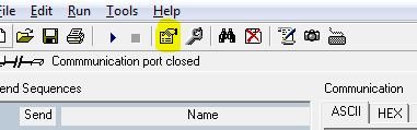

  • Hello Stephan,
    Here is a the link to download Docklight : http://www.docklight.de/download/Docklight.zip
    The tool is pretty easy to use. When you open the ptp file Josh provided, follow the next steps:
    1. Click the Project Settings button (shown in yellow below)
    2. Select the correct COM port from the drop down menu.
    3. Click the Connect button (button to the right of the print button in the image above)
    4. Click on the send button next to each command sequentially.
    Note: There will be some commands that will require that you change the HEX data in the command, you will have to double click the command and change the appropiate bytes.
    Hope this help!
    Erick M.
