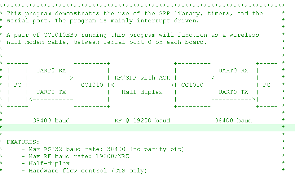

I am working in my thesis degree in engineering.
I have the need to transmit SPI data from a external device, by RF, and then receive it in another external device (like using a cable). I am planning to use the "CC2544" for this purpose. The baud rate of SPI is not greater than 1 Mbps, so i think CC2544 will work fine (it´s support a 2 Mbps RF baud rate).
I´m using CC1010 in a similar way, but transmiting UART data, as shown in the image:
(It´s a example from example library of CC1010). With it example, i can transmit data in a "transparent" way between two UARTS from two external devices. Fortunately, this works very well.
I need to do the same thing, but using SPI DATA in a 1 Mbps Baud Rate. For that reason, i thinking in use a CC2544.

  • What kind of SPI device are you communicating with? Remember that for every packet you send over the air, there's some overhead in the packet itself (preamble, sync word and possibly also a CRC field). So the length of your packets will determine the effective datarate you'll get. Also keep in mind how the SPI protocol works: The master provides the clock and you'll get data bits from the slave for each clock pulse. In a wireless setup, using a packet oriented device like the CC2544 (or any similar device) you'll have to send the clock pulses (train of clock pulses or just the number of pulses, together with any data coming from the master) as a packet to the remote node (slave), which in turn toggles the clock line (and slave-in line) to the SPI device, buffers the incoming data and transmits back to the master. So you won't be able to get a transparent SPI implementation. However, it is possible to make it work, as long as you adopt the way the master communicates with the SPI device. You might want to add some intelligence to the remote node that handles the direct communication with the SPI device.
