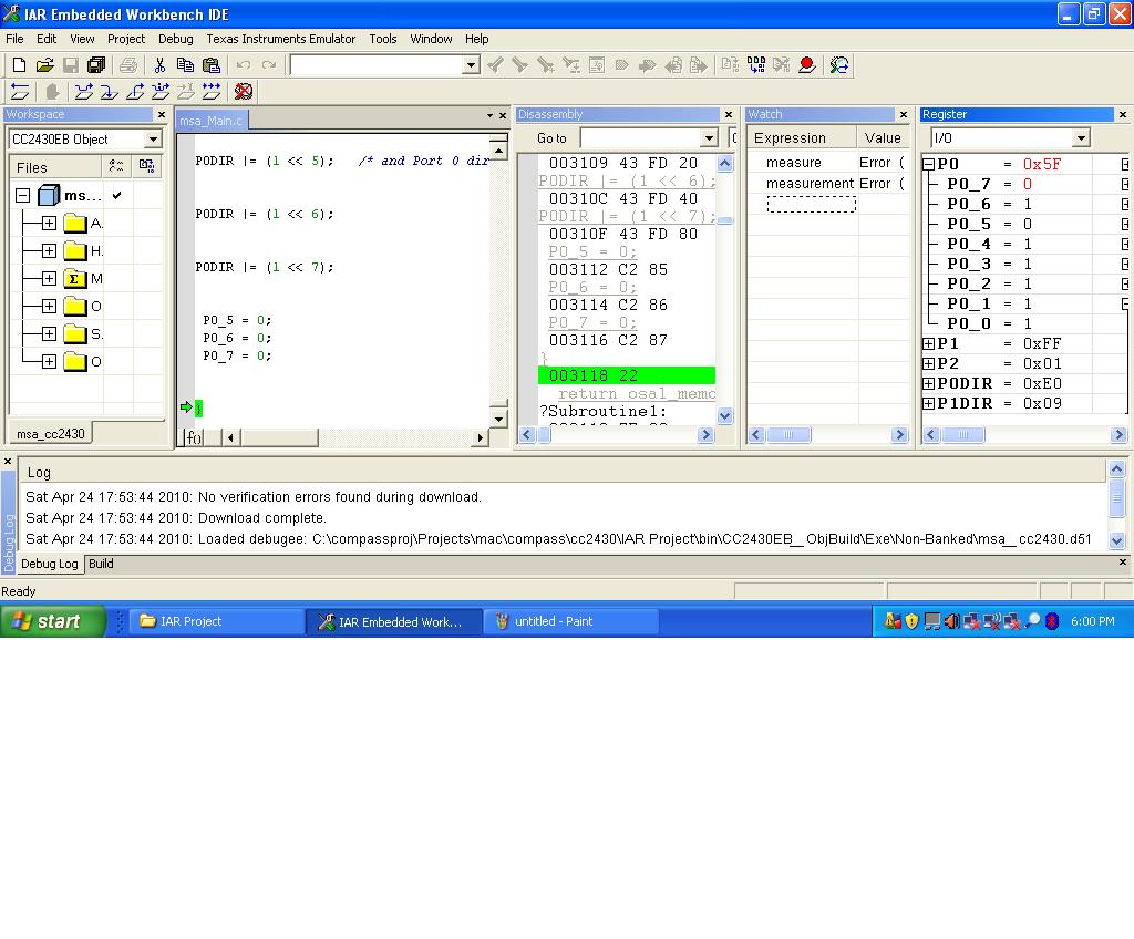

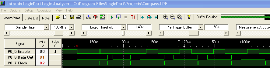

Hi I am hooking a compass to the CC2431 blind node. The compass is already hooked to PO.5, P0.6 and P0.7. I am basically trying to send data to the compass and need to know how to send siganls to these pins. What function is there to send signals to these pins? I looked in the iocc2431.c but I could not find it. So please let me know which functions I need to use to send siganls to these pins. I am kind of new to this area and would really appreciate some help as I want to write a driver for the compass hooked on to the SOC_BB's Port 0. Thanks.

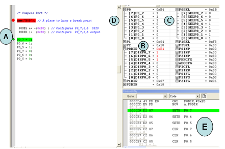

    Reviewing the CC2430 data sheet (page 83 of 211) will help understand the following. Using the ports as I/O is easy and only requires a few commands to get started. First you have to set the P0SEL register to 0 for the pin you want to use if you want to use it as a GPIO (general purpose I/O) port and not a peripheral such as SPI or something else. Next you have to set P0DIR bit for the port pin you are setting  to 1 if you want it to be an output. That is all.   Now if you write  P0_7 = 1;   Port 0 bit 7 will become high. If you write P0_6 = 0; Port 0 pin 6 will be low.
    int main(void)
    // PORT 0
    // Anything after double slashes are comments and not code
    P0SEL &= ~BIT7    // Set P0 bit 7   to 0   for GPIO  (see note at the bottom)
    P0SEL &= ~BIT6    // Set P0 bit 6   to 0   for GPIO
    P0SEL &= ~BIT5    // Set P0 bit 5   to 0   for GPIO
    P0DIR  |=  ( BIT7| BIT6 | BIT5);                      // Set P0 bits  5, 6 and 7  to 1 so they will be outputs
    // PORT 1  I include Port 1 so you can change P1_0 and P1_2 on the SmartRF04 as an exercise to see if it working
        // Initialize P1_0 (Green LED) and P1_2 (Red LED)
        P1SEL &= ~(BIT2 | BIT0);              // Set to 0 for GPIO
        P1DIR |=  (BIT2 | BIT0);                 // Set      1 for Output
    P0_5 = 0;    //  Sets P0_5 to 0
    P0_5 = 1;     // Sets P0_5 to 1
    x = 0;           // Set x equal to 1   Be sure to define x before you use it, something like      int x;
    P0_6 = a;   // This will set P0_6 = 0 and make Port 0 pin 6 low
    P1_1 = 0;  // This will turn on the LED if there is one on Port 1 pin 1 as on the Smart RF04 board
    P1_1 = 1;  // This will turn off the LED if there is one on Port 1 pin 1 as on the Smart RF04 board
    You can get fancy and add steps to make the code more readable by adding a label to P0_6 =1; so it is easier to follow. Remember they are only labels you make up. It would look something like this:
    #define compass_off   (P0_6 = 0)
    #define compass_on   (P0_6 =1)
    int main(void)
    //  PORT 0
    P0SEL &= ~(P0SEL | BIT7 | BIT6| BIT5);        // Set P0 bit 7, bit 6 bit 5 to 0   for GPIO  (This is the same as above but all on 1 line)
    P0DIR  |=  ( BIT7 | BIT6 | BIT5);                        // Set P0 bits  5, 6 and 7  to 1 so they will be outputs
    compass_off;   // set P0_6 low
    compass_on;    // set P0_6 high
    Note:  I do not know your c skills and aplogize if you know the following, I do not mean disrespect:
    P0SEL &= ~BIT7;    // ~ is NOT,  BIT7 is defined in the INCLUDE files as 1000000, so NOT 10000000 is 01111111.  & is AND.  When we AND 01111111 with P0SEL if bit 7 is a 1 it will become a 0 since 1 AND 0 = 0. All the other bits will stay unchanged becasue if they are 1 then 1 AND 1 is 1 and if they are 0 when AND with 1 they are still zero. This is how we set P0SEL bit 7 to 0 without changing the other bits.
    So now look at        P1DIR |=  (BIT2 | BIT0);          where we want P1 bits 2 and 0 to be 1.  Remember |  means OR.      So we have BIT0 (00000001) OR with BIT2 (00000100) and we get 00000101. When we OR this with the  P1DIR 8 bit register bits 7 through 3 and bit 1 do not change since we are OR 0 with them. 0 OR'd with 0 stays 0.  0 OR'd with 1 stays 1. Since bits  2  and 0 are OR'd with 1 they become 1 or stay 1 if already a 1.
    Let me know if this helped or if there are more questions.....
  • I have made several edits to my post above to correct numerous errors. I see I still have a P1_1 that should be P1_2.

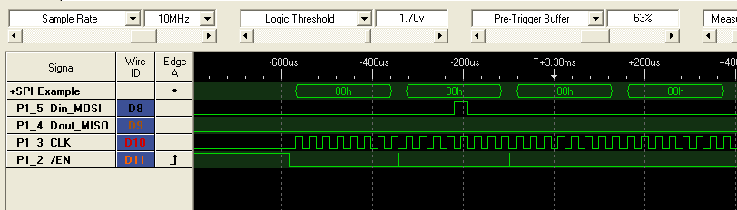

    Is the compass interface SPI? Do you plan to bit-bang it using GPIOs?

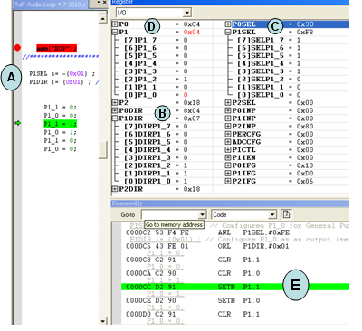

  • I'm having trouble with this one too, though I am using a CC2510 and a slightly modified version of simple_link.
    I'm trying the following:
      P0SEL &= ~(0x01) ; // Configures P1_0 for General Purpose I/O (sets to 0)
      P0DIR |= (0x01) ; // Configure P1_0 as an output (sets to 1)
      P0 |= (0x01) ; // Drive P1_0 high  (1)
      BSP_SleepFor( POWER_MODE_2, SLEEP_1_MS_RESOLUTION, 1000);
      P0 &= ~(0x01) ; // Drive P1_0 low (0)
    I have added includes:
    #include "ioCC2510.h"
    #include "hal_defines.h"
    When I check with a Multimeter on voltage connected to ins P0_5 and GND, no matter what I try, I keep getting 3.18V.
    I've tried P0_5 = 0, P0_5 = 0x00, I've tried turning off ADC and I2S and all kinds of things and I'm really getting stuck.
    Any ideas for me to try? Thank you! You guys rock!

    P0_5 = 0;
    P0_6= 0;
    P0_7 = 0;
    This I done in the function called clearBits( ) inside msa_Main.c  inside the source code.
    When I debug and trace the values P0_5 and P0_7 change to 0 but P0_6 does not
    This is really strange and beats me
     Again here is where the source code is - http://e2e.ti.com/members/1486773/files/compassproj.zip.aspx

  • You write "I already set  P0DIR &= 223 but still not work . "         223 is pin 5, not pin 6 of port 0
    During debug do you see P0.6   STB    or     P0.6 CLR in the dis-assembler window when you single step past P0_6 = x;
    I wil look at the code tomorrow.

    I could not debug your code. I have  the IAR Kick Start edition which is limited to 4K bytes.
    See the graphic below:  You  can see the (A.) c code, (B.) P0DIR status, (C.) P0SEL status, (D.) P0 port status and in (E.) the assembly code which clearly shows P0.x  being cleared and set with assembly CLR (C2) and SETB (D2)  instructions. In your posting above this can be seen if you widen the disassembly window.
    Realize you can toggle P0_6 and "see"  the change in register view (see D) but if P0SEL has not connected the external pin P0_6 to the I/O, and P0DIR has not connected  the I/O pin to the output driver, the change will not be seen on the external pin P0_6 on the CC2430 package.  The P0_6 register is not the same as the P0_6 pin, they must be connected via register settings.
    I suggest you copy and paste the code below into your program. As you step past the P0_6 = 1; and P0_6 = 0; instructions note  P0DIR, P0SEL status and  measure the pin with a voltage meter or logic analyzer.  I used a logic analyzer and it worked as expected.
    asm("NOP");                  // A place to put a break Point
      P0SEL &= ~(0xE0) ;    // Configures P0_7,6,5  for General Purpose I/O (sets to 0)
      P0DIR |=      (0xE0) ;    // Configure   P0_7,6,5  as an output (sets to 1)
          P0_7 = 1;
          P0_6 = 1;
          P0_5 = 1;
          P0_7 = 0;
          P0_6 = 0;
          P0_5 = 0;
  • Hi Mr. H I would like to trouble you one more time if you don't mind. As you have helped me with the compass code that I posted I have questions about the compass code itself. I am now having the problem of clock delay (clock settling time ) between bits transferred and recived. Because of this I presume the code did not work.
    My modified code can be found at http://e2e.ti.com/members/1486773/files/Compass.zip.aspx
    The compass documentation ( application note + data sheet ) can be found at - http://e2e.ti.com/members/1486773/files/Compass_5F00_Docs.zip.aspx
    The compass data sheet shows the timing diagram and is very difficult for me to understand. What parts of code should I put to delay the clock output in between sending and recieving bits to and from the  so that I can synch in with compass from Port 0.
    Open my project - unzip the Compass.zip file - browse to \Compass\Projects\mac\compass\cc2430\IAR Project\ folder and open msa_CC2430.eww. Please find the file msa_main.c   which contains the main( ) function. Inside this main( ) function is my code. Please let me know

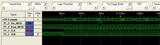

  • I believe I have the same setup minus the compass.  (SOC-BB + CC2430EM without the compass)
    The logic analyzer output shows what the code is doing. At this zoom level it is hard to see the short enable transisition at -175us in the top graphic. This short enable toggle should be followed by 4 clocks with data at 0 proir to enable going high again to force a reset.  The second graphic is zoomed in around the -140us point on the top graphic so you can see the "clock" and enable. At the -50us mark it goes into a loop where once again 4 clocks are set during each enable low.  This is in effect a continuous reset.
    I have also attached a c file that captures just the compass code and required header files and suggest we just exchange this file going  forward. Importing your entire folder risks corrupting my project files long since cleaned of the very verbose HAL files. I think we can get through this quickly.  Time permitting I would also like to send you a variant based on SPI.

  • Take a look at the code. Below you can see the 00 sent for reset between two /EN and the start of measurement 1000b. It is a polling approach and is waiting for a 00001100 to be returned on the MISO/Dout line. Since I do not have a compass it does not get past the while(meas_not_complete).
     I apologize in advance, I should not write code after midnight. The code should work, it has a couple of flaws. I send the start measurement with a 0x08 and it should be 0x80 as you can see below. Also there is a small chance it could return a data ready in  the same byte as the 0x80 which as written would be missed. I do not start polling until the 3rd byte.
    Compass-with-SPI.zip
