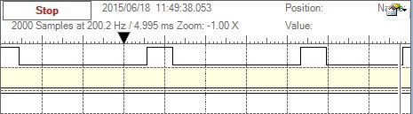

    So, let me tell you what i tried out: Below you can see my ISR for the TA0. It's simple, if LED on, turn it off and set timer to 50000, else turn it on and set timer to 10000. So far everything works fine (the output pin will drive a transistor to switch the LED).
    Fig1: TA0 toggling at Port1.0 as expected.
    Now, if the LED should be turned on, the voltage doubler needs to be active, due to the LED is driven by it. But if I force the voltage doubler by setting the EN_V_DOUB to '1' (see commented part of code) the timer is malfunctioning!!
    Fig2: TA0 toggling at Port1.0 after "RFPMMCTL0 |= (RFPMM_EN_V_DOUB);" was uncommented in the code.
    In Fig2 you can see that the output is totally malfunctioning because of setting the EN_V_DOUB to '1'. So what influance has the voltage doubler to the timer function?
