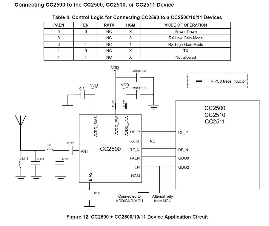

CC2500 matching to CC2590 is a better choice than to use CC2592
Other Parts Discussed in Thread: CC2592, CC2590, CC2500
If I don't need the extra RF-power that CC2592 can boos, then it seems that CC2590 is a better choice instead of use CC2592.
If I am right the CC2590 can be added directly to CC2500 outport w.o. any matching (the small mismatch is not to bother about). Is that correct?
