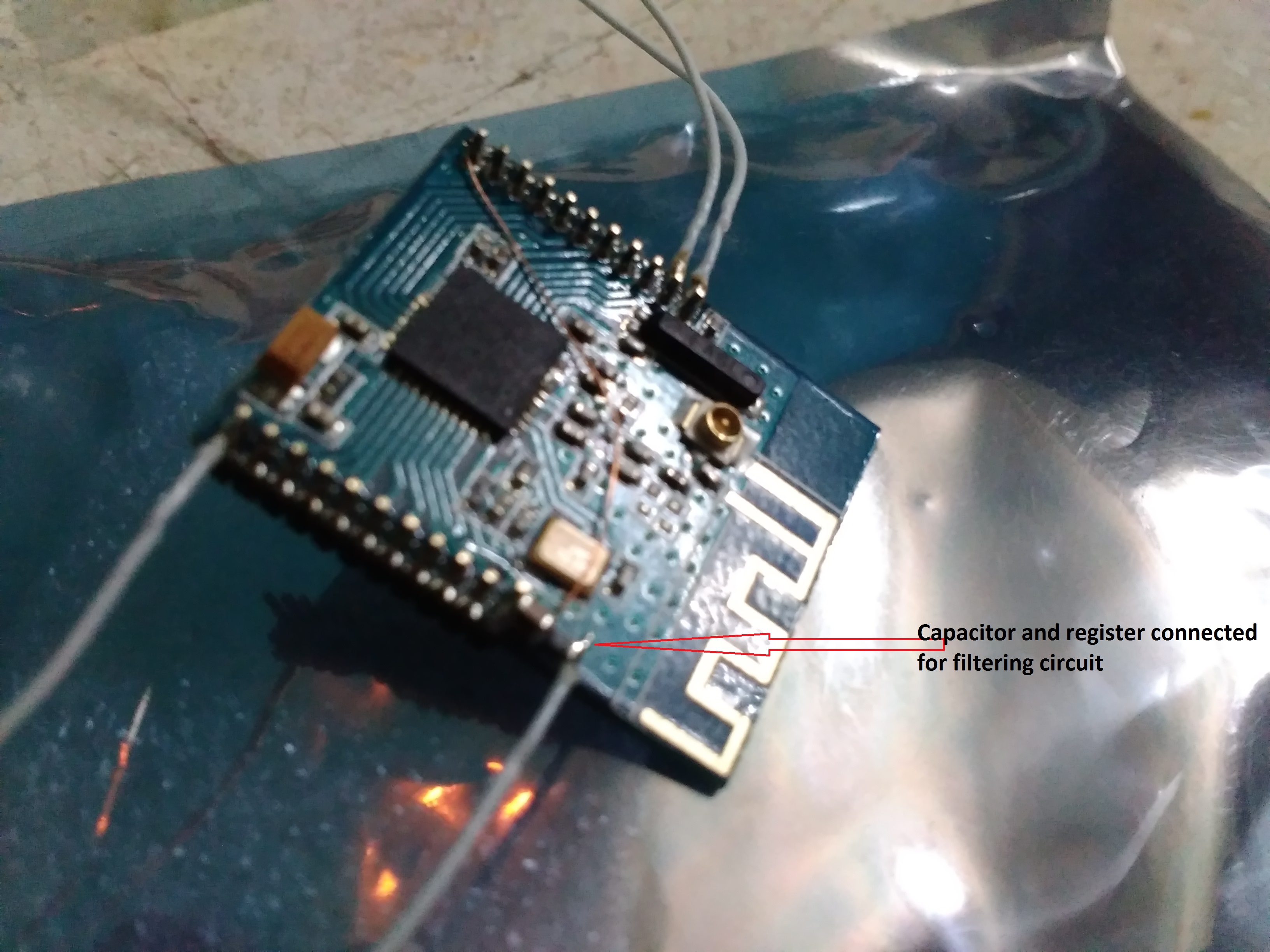

I am trying to access cc2530 with cc debugger. I am following the steps cc debugger user guide and the community talks to doing the connection. But tillnow I am not able to access the evm. Can some one help me.

Another thing, it is very common for the Debugger+cc253x chip to behave erratically, when cc253x Ground PAD is not well soldered to the ground.
The CC2530 is now getting detected by the debugger and the led turns green. we dont need any filtering ckt, pull ups or no need to any connection to pin2 on the debugger to the vin on the board.
I have two boards, one is having filtering ckt added. Other is not. When I probe the voltage vin pin I was getting 0v. So I tried with the other and worked fine. May the filtering ckt I have added have some problem otherwise issue with the ground connection in the board. Before adding the filtering ckt also I had tested the board1. But it was not getting detected. May be that time it was a connection issue, but I did not had multimeter that time to test.Thanks for your time and help.
