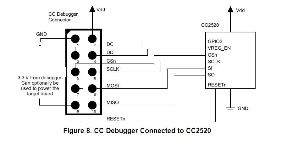

  • PM,
    I decided to go with the CC2520. For programming this one, is the CC Debugger required? Do I need hardware pins for programming or can I do it wirelessly? If I do need hardware pins, can you tell me how many I need/ which ones?
    Thanks in advance!
    Ena
    CC2520 is only a Transceiver. You need to interface CC2520 with a Microcontroller by using SPI bus and other GPIO lines.
    Please refer to sections 9.8, 9.9 and 10  of CC2520 data sheet for further details.
    CC debugger can be used to control CC2520 by using SmartRFStudio. Please refer to Figure 8 on CC Debugger user guide for CC2520-CC Debugger interface connections. This is only useful for testing purpose.
    PM
  • PM,
    I'm not concerned with the firmware part of it. I want to know how to physically connect the programmer to the IC; which pins do I use? From what I read, it looks like it is a 4 wire interface, can you please confirm this?
    Also, is there a way to program it without any electrical connections at all?
    Thanks.
    CC2520 has no memory to hold the program. It has a limited RAM that can be used for internal purpose only.
    You can control CC2520 by using it's SPI bus. The following physical interface is required to control CC2520.
    There is no way to control this device without any wires.
