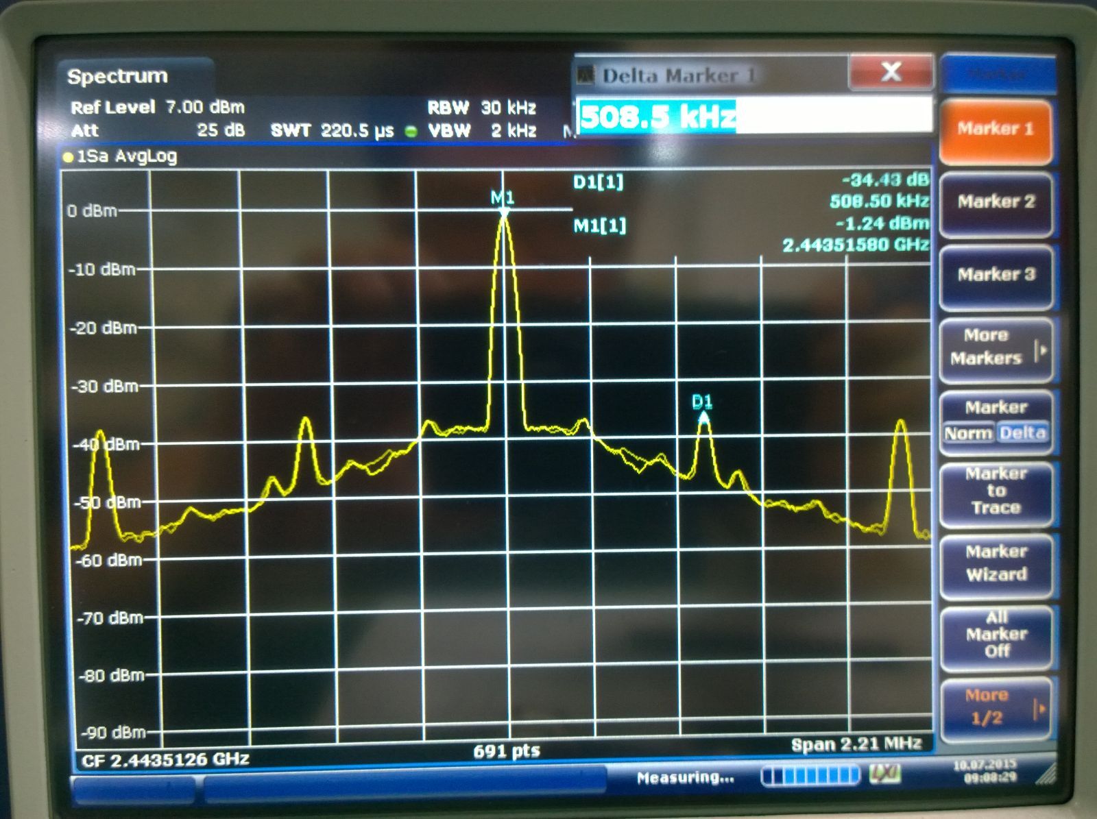

The phase noise and Spurious emission of CC2510 at the unmodulated carrier, show in the picture . what dose happen in my design? the cystal is 10ppm . And i have another question at the DGUARD PIN, what is it function?
The spurious at D1 is located at 2444MHz which is 94 * 26MHz or an integer channel of the XTAL reference. It should not pose any issue in your system as it is 36dB lower than the carrier.
