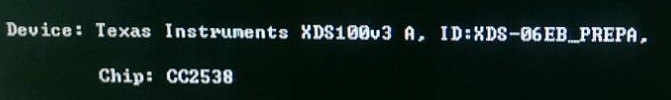

I connect two smartRF06+CC2650EM in my PC,  but there is only one device display in flash programer 2. I find out the two smartRF06 have same ID(XDS-06EB_PREPA)
please tell me how to change ID or how to resolve this problem. thanks

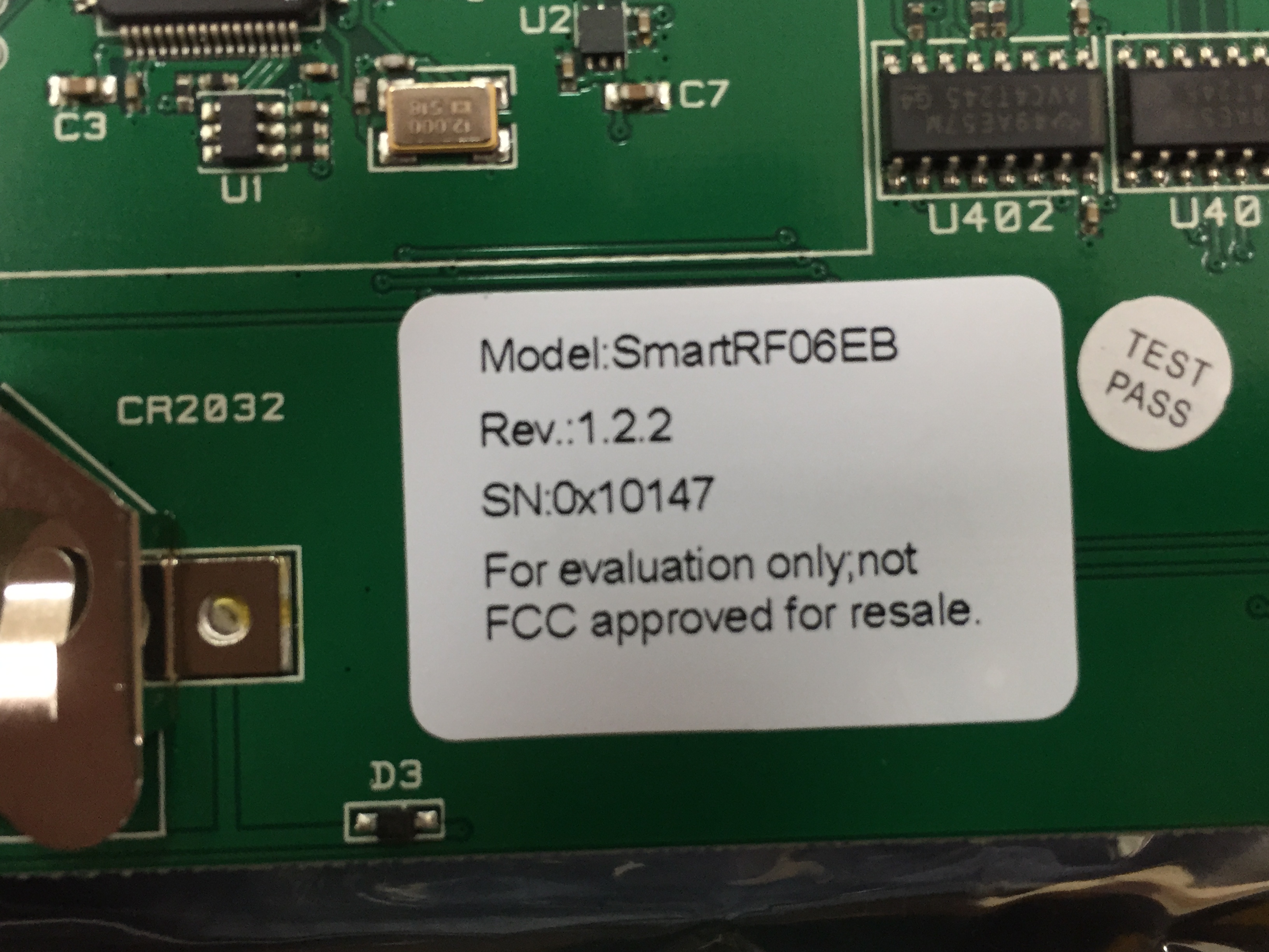

  • Can you please provide a picture of the version number label on the board? We would like to check this with our board manufacturer.
  • Hi M,
    please check attachment
  • Thanks!
