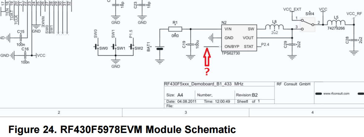

About TPS62730 mounted on RF430F5978EVM
Other Parts Discussed in Thread: TPS62730
About TPS62730 mounted on RF430F5978EVM.
Where is the ON/BYP pin of TPS62730 connected?
www.ti.com/.../slru007.pdf
Seishin
  • in global.h firmware reference file it (BYPASS) is defined as P2.2
    #define BYPASS                   BIT2
    #define BYPASS_OFF          P2OUT |= BIT2
    #define BYPASS_ON            P2OUT &= ~BIT2
