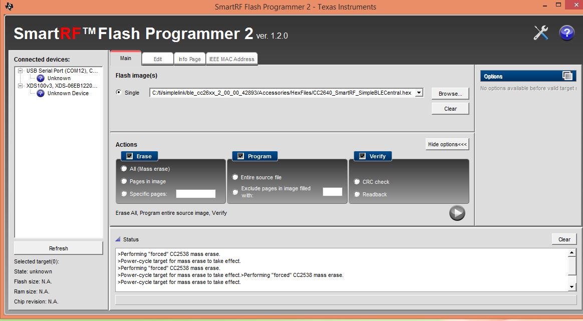

I am using CC2650EM board. This is the error I get on SmartRF

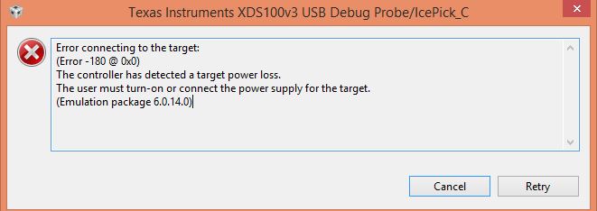

When I am trying to program it on CCS I get this error

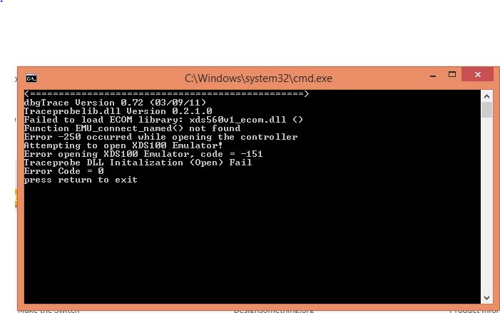

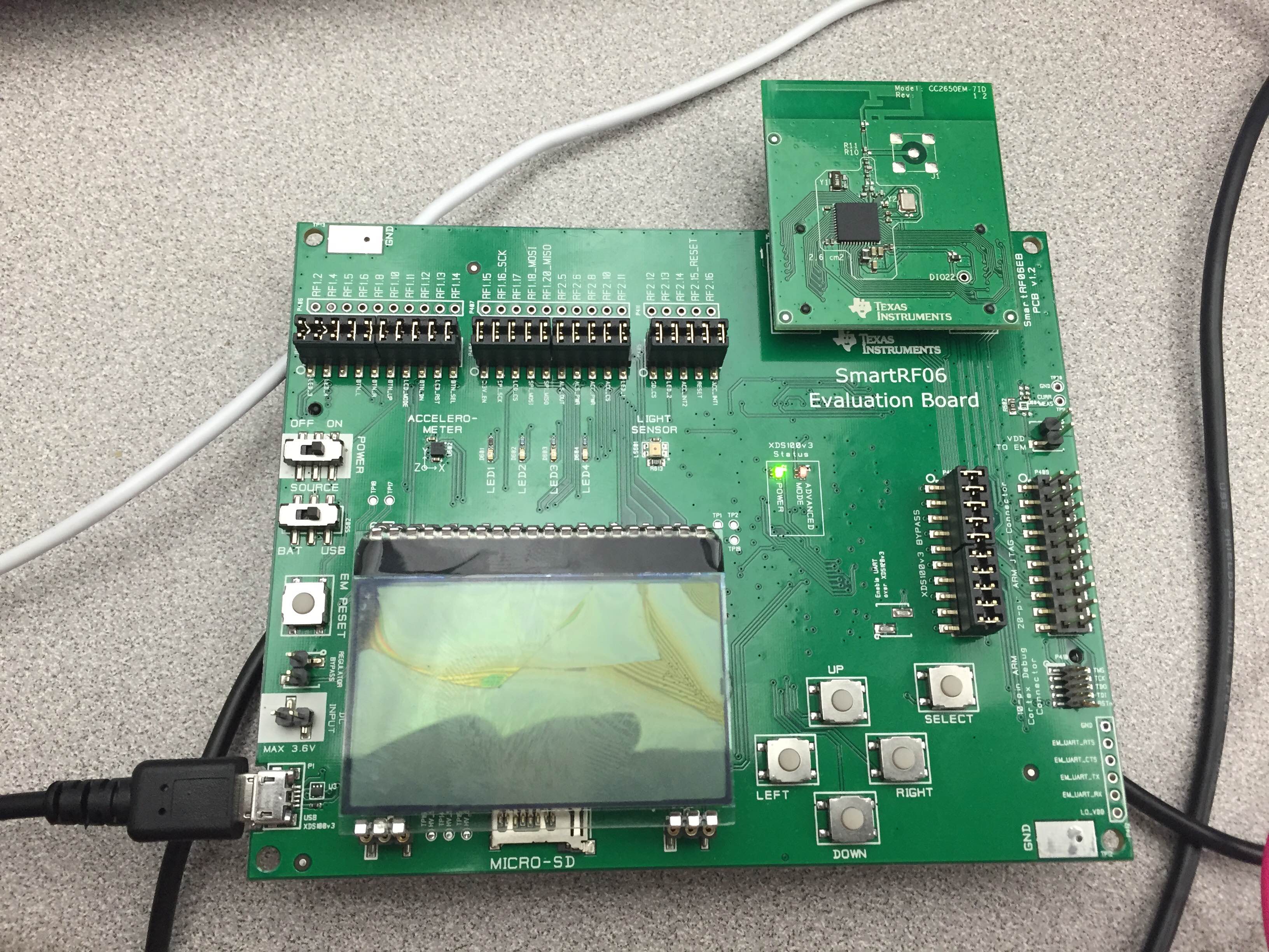

I checked using the xds100serial.exe and there is a debugger listed over there.My Selector is on USB on SmartRF board.both the LEDS on msart RF board power,advanced mode are on.
What could be the issue
I see the problem. You have to put a jumper on VDD to EM pins of SmartRF06EB ( at right corner).
