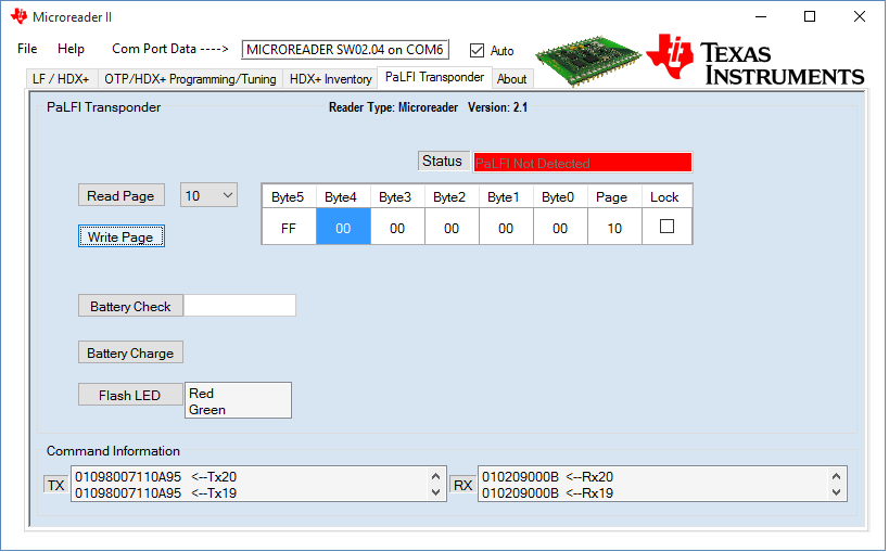

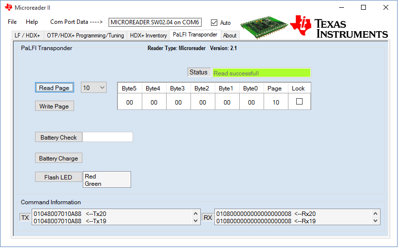

  • Hi John,
    Thanks for the reply, here are some screenshots.
    First a successful read:
    Followed by a failed write to the same page:
    The packet sent out by the Gui software seems to be correct. I even tried to send the same packet to the MRD2 using realtem but (not surprisingly) got the same reply.

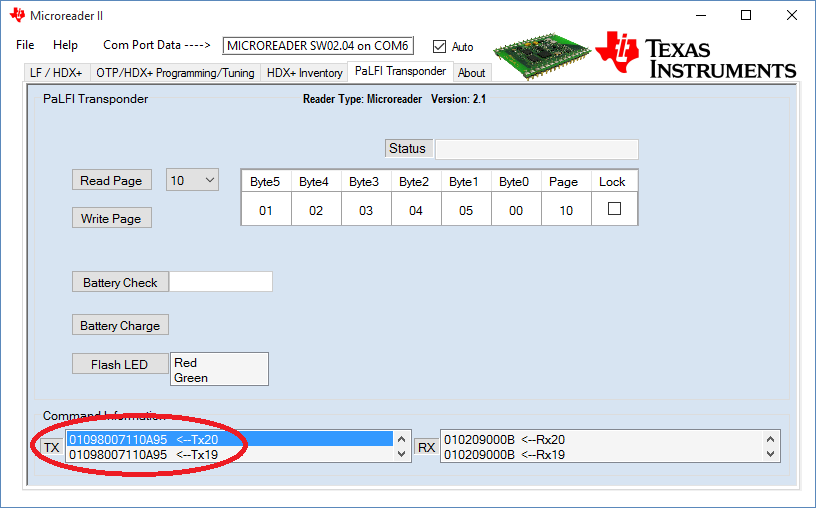

  • Actually, I am not sure if the transmitted packet is correct, shouldn't it include the 5 data bytes?
    In any case even trying different packets in realterm I cannot seem to get any activity on the MRD2 during a write command.
  • Update:
    Following the ECM packet format in the MRD2 Guide I am able to write to the TMS37157 pages (sending packet to MRD2 via realterm).  Trying to do the same thing using the microreader demo software it doesn't work and the packet sent to the MRD2 is wrong.
    For example the correct packet to write page 10 is: 0x01 0x09 0x80 0x07 0x11 0x0A 0x01 0x02 0x03 0x04 0x05 0x94 (works fine via realterm)
    Trying to write page 10 from the microreader demo software, the packet sent to the MRD2 is 0x01 0x09 0x80 0x07 0x11 0x0A 0x95 (see screenshot below). it is missing the data bytes.
    So this appears to be just a bug in the microreader PC software.
