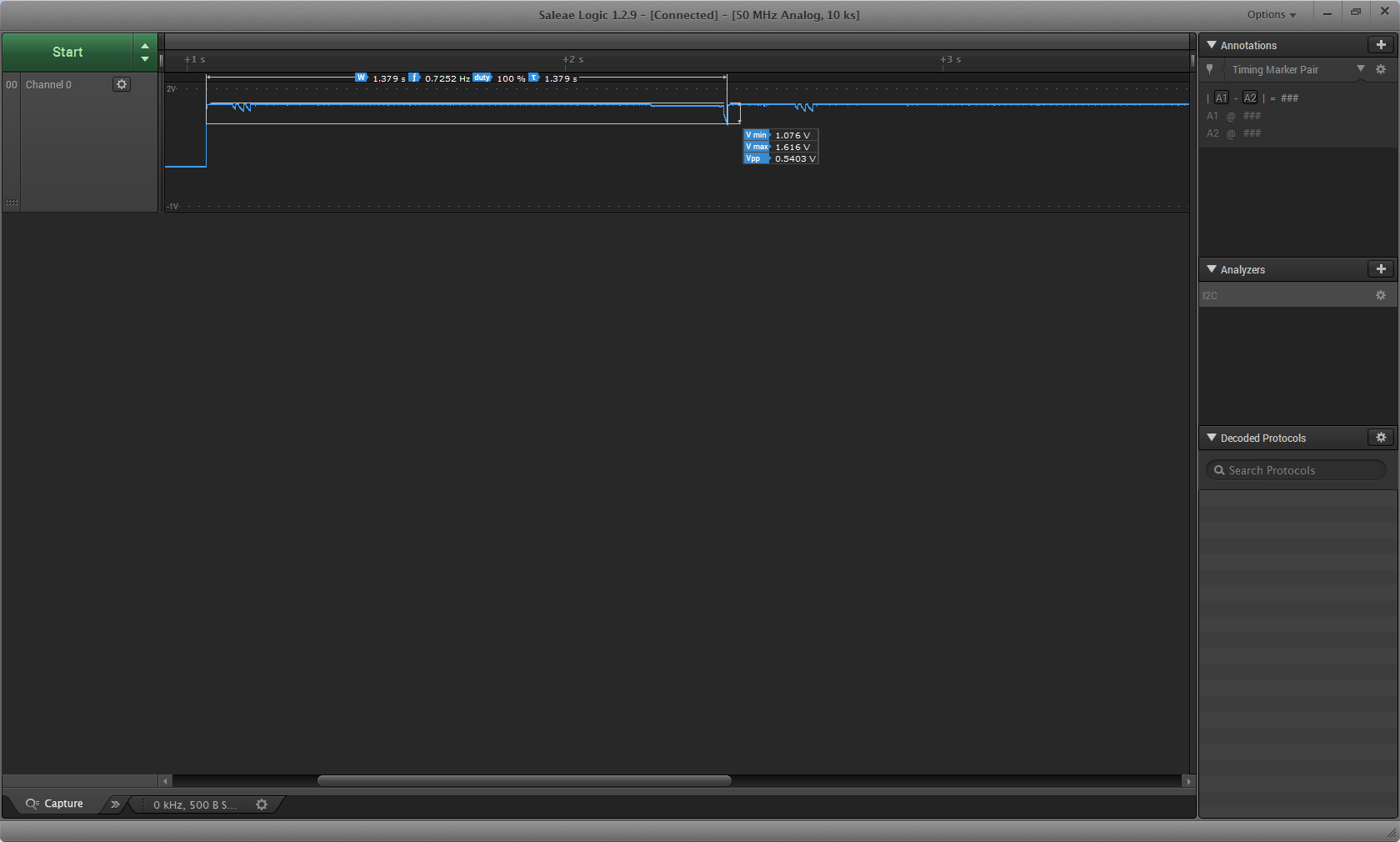

  • On the same topic of external sensors, as part of fault testing the interface to a humidity sensor, power to the i2c slave was disabled, causing the supporting routine coupled to DIGITAL_SENSOR1 to hang.
    After some amount of time, the rf430frl152h reset, with ResetError in the Error Control Register set, and the power on logging of the reset condition from SYSRSTIV was set at 0x02, indicating a BOR.
    Verifying the watchdog and timer registers prior to causing the hang did not seem to show them active. I'm assuming a software BOR is initiated if the sensor sampling routine takes too long, and am attempting to verify what that time out is set to in the ROM.

    Have replicated it with the device completely disconnected from the circuit (ground, power, scl/sda), to the point where no external circuitry is drawing on the rf430frl152h.
    Also tried a busy loop while(1) at the start of the sensor data collection method and caused the same behavior, no I2C interaction at all.
    If there's no software BOR in the ROM, then perhaps this interaction is causing an abnormal draw.
    Karl
  • Only thing that comes to mind is if running the CPU for long periods of time is draining too much power, such as from battery and causing a brownout.
    Would be useful to capture the VDDSW power rail on a scope with this issue.
  • Actually it would me more useful to capture the VDD2X power rail since that is the most sensitive power supply.
  • Seems as soon as it hits any sort of busy loop (whether it be the infinite loop, or the busy wait checking of flags in UCB0IFG), it will dip VDDSW down to almost 1V. That timing correlates with the restarts.
    This is currently over RF power, which is the goal for this implementation, but does provide insight into the issue.
    Under normal conditions, it will typically only dip ~50mV during any sampling, keeping it well above 1.5V.
    Karl
  • In this case it would be wise to avoid polling loops. The digital sensor driver can be rewritten to use interrupts to communicate with the digital sensor. This would be very power efficient and should prevent a brownout if the communication hangs.
  • Agreed. Thanks for the help and insight.
