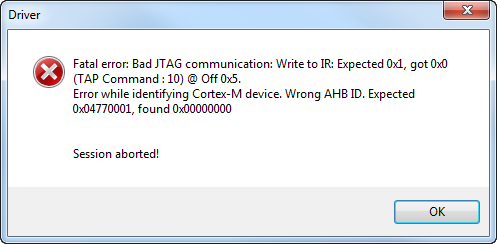

I am having CC2650DK and I want to flash example project using the 10pin JTAG header from IAR . As per the smartRF06 user guide,  I removed the XDS100v3 headers(P408) and connected the  development kit via Jtag debugger. In the debugger options, I changed TI XDS to Jlink/Jtrace . Once the change is made, IAR crashes with the message attached.
 I tried using Jlink base as well as Jlink Pro. I have installed the latest Jlink segger V502f  driver from the link www.segger.com/jlink-software.html
Can't Jlink be used for flashing to cc2650? what am i doing wrong? Please let me know.

    Can you check if the option "drv_communication" is defined under Project -> Options -> Debugger -> Extra Options in your IAR project?
    If it is, you could try remove this option from there and see if that helps.
    Which software and version are trying to download?
    Bjørn
    I removed "drv_communication" from the project->options->debugger->Extra options. The previous error message is gone.

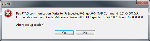

    I removed the XDS bypass header, connected Jlink EDU and changed debugger to JLINK/JTRACE. Now the message coming is
    "Cannot get CPU status after 4 retries". I tried with and without XDS debugger header. At times the message is "Bad JTAG Communication" "Abort debug session" . Is there anything else which needs to be done?
    The jumpers on the "XDS100v3 bypass" header should be removed. The J-Link should be connected to the header marked "20 pin ARM JTAG connector" (P409) at the edge of the SmartRF06EB board. Make sure pin 1 on the connector is placed correctly on pin 1 on the header.

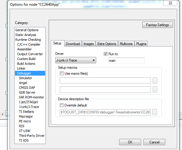

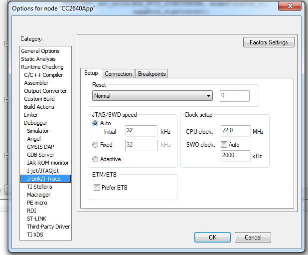

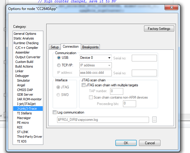

  • Can you share screenshots of your IAR project settings? Project > Options > Debugger, and Project > Options > Debugger > JLink.
    Edit: I've attached my simple blink led for IAR 7.40.3 + CC2650. Select the "Jlink" build configuration.20151022_cc26x0_blink_led_ewarm7_40_3.zip
    I am attaching the screen shots of the project

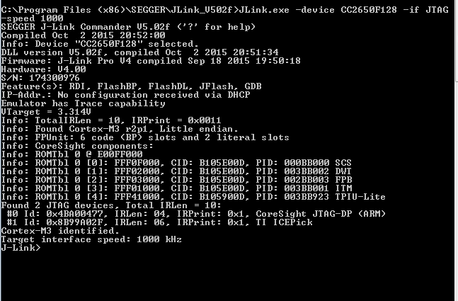

  • Hi all,
    My name is Erik and I am a member of the J-Link development team.
    We, the SEGGER J-Link team, are not aware of any issues with CC2650 in the latest version (5.02f) of the J-Link DLL. We just gave the "simple blinky test project", TIABO posted below a quick try and it is working just fine here on the evaluation board. We have been in contact with TI regarding this project and they can confirm that it is working on their side as well. The error in the TIABO's post was related to an hardware setup issue.
    Do you see any issues using this project, too? If not, it seems to us that the issue is related to the project configuration.
    For the case you see any issues, can you please download the J-Link software package and start the J-Link Commander (JLink.exe) with the command line options as below and upload a screenshot of the entire J-Link Commander output?
    JLink.exe -device CC2650F128 -if JTAG -speed 1000
