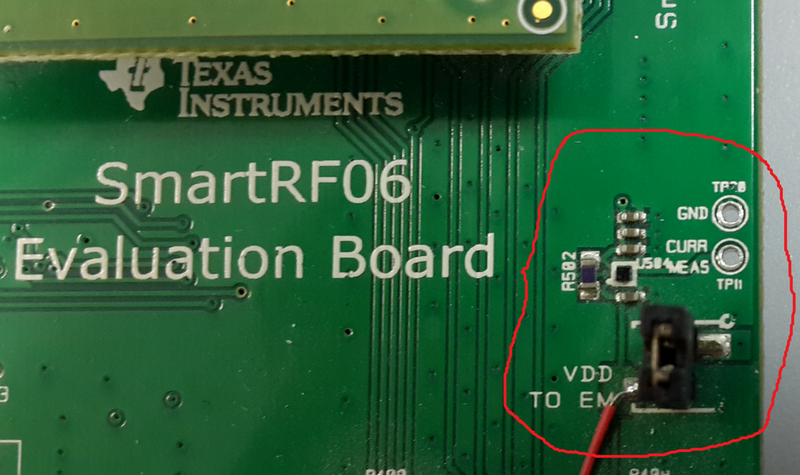

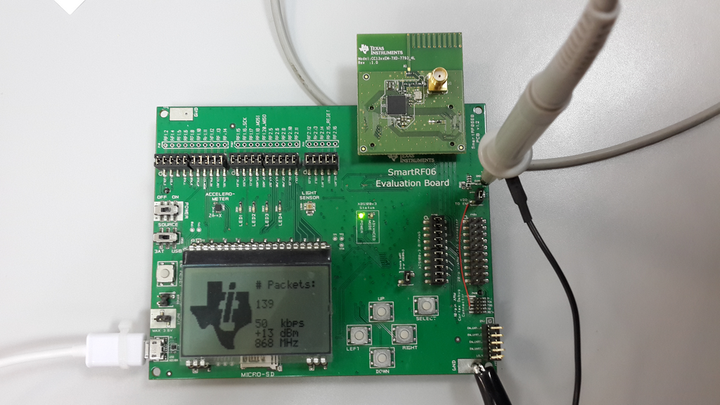

I'm using the SmartRF06 with a CC2650EM. I'd like to measure the high frequency current consumption of the BTLE module. I have my MDO3014 connected to the Curr Meas pin and the ground connected to the pin next to it (labelled GND). The output of the scope is shown below. I expect to see the current increase as the BTLE module advertises for connection. If this signal is here, it's buried in the low frequency noise. Is there anything special that I need to do to use the current measurement connector on the SmartRF06. The documentation indicates that this is the output of a Op-Amp with gain. So, I should be able to connect it directly to my scope. Any suggestions would be appreciated.
